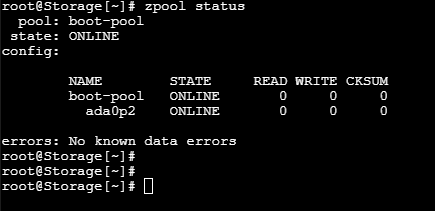

New installation by new TrueNAS nob.
Installation was perfect via bootable USB (I chose the TrueNas) installation was completed and I can access via web interface. Changed root password, IP address to static and workgroup to workgroup. The rest is unchanged, but in the storage/ pools I can create a new one ... there are no available disk.
Help..
I did a zpool status and I get this:
How can I fix this ??????
Thanks

The Mac mini 2014 only has 1 disk, and you used it up for your boot pool.

Oh Yes, I see my issue, looks like I have a huge (1TB) boot pool, ... any suggestions during my re-installation ? maybe a 2G boot and the rest for data available. I am really trying to create a simple configuration with a one big drive that I can store files at home and its easily available via windows machines.

Unfortunately, the installer will use the whole disk you select for the boot volume. You'll need to try a different platform.
