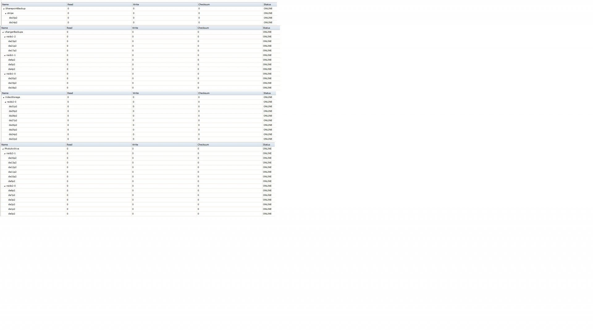

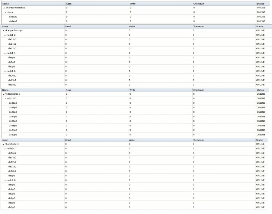

Would that also apply when I go to 'storage/View Disks' and I see all the disks......
but when I go to each of my volumes and click on 'View Status' I see the drives that it is using (same when I did it from teh command line)
for example:
Vol#1 it has Da15p2 and da14p2 = 2 drives
Vol#2 has 3 sets of raidz1 (3 drives each) = 9 drives
Vol #3 has 1 set of raids2 = 8 drives (4 each)
Vol#4 2 sets of raidz2 = 12 drives (6 each)
From what I see, only 20 drives are being used.
but "storage/view disks" is showing 39, that as far as I can tell, are all online.
Is there a command that I can type in that would verify that all 39 are online, or some dead that I dont see via teh GUI?
or am I just completly off base here?

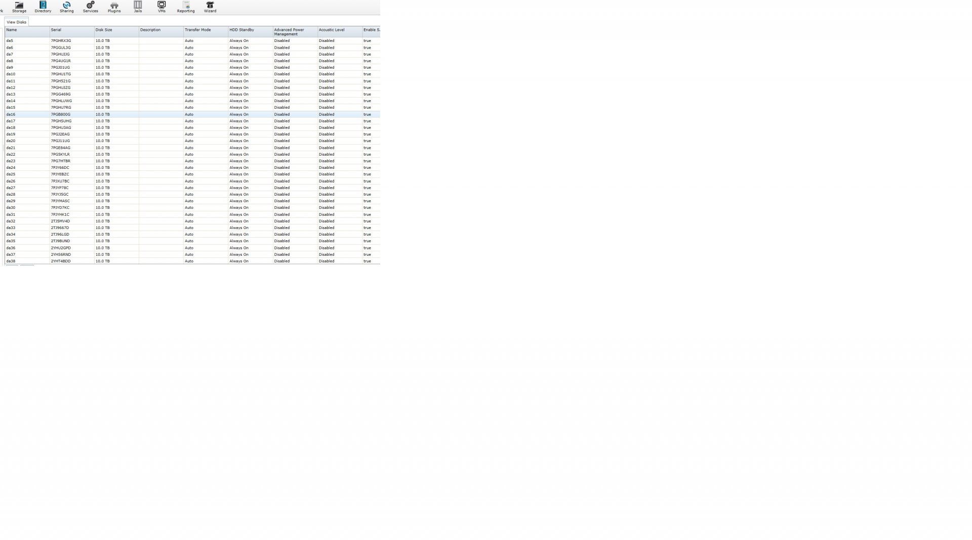

the attached image will show exactly how many drives are with each vol. (drives.jpg)
and the results of the perl script is in result.txt
  • result.txt
Chris Moore
May 2, 2015
10,079
I go to the CL and enter in zpool status, I can only account for 21 disks being used. (same when I use the gui to look at the disks being used for each vol)
So, looking at the data you have shared, it looks like you have accounted for 31 drives already allocated to pools, which leaves 8 drives available for use and all drives accounted for. Is the question answered?
