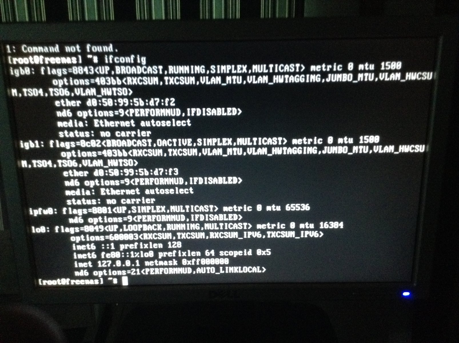

No matter what I seem to do (e.g., taking a variety of advice by combing this forum), I am unable to connect to the freeNAS machine in my home network. I continually get the "No configured interfaces were found" message, and when I try to manually configure and the OS subsequently spits out a URL, the URL does not work, and my router still does not show that anything is attached @ the URL provided. I've entered "shell" and typed "ifconfig", and attached the output.

  • Try a known-good Ethernet cable (ifconfig says no carrier)

Also, he shows an igb0 and igb1. So he has two ports, both equally good. He might try the other port on the FreeNAS.
I doubt this is a bad board. Almost certainly a bad cable, or a bad choice of port.

Thanks for the quick responses. I'm going to show my ignorance here, but to clarify: Ericloewe, my router appears to have only 4 "LAN" ports (I don't see any designated as IPMI on the router itself). Also, I've switched out the ethernet cables multiple times with ones that I'm sure work.
To thicken the plot a bit, I've noticed that when I connect and boot up my FreeNAS machine, and I log into my router manager online (wirelessly, from my laptop), the router manager shows that a new device is connected. When I go to the URL listed for the device, I see a login screen for my motherboard (the ASRock) from my FreeNAS machine. I am able to login and configure the motherboard from there (though I've not messed with anything). In light of this, doesn't it seem like the connection is working properly (and the issue lies with the FreeNAS software)?

PS -- I meant to also mention that I'm not sure I understand what DrKK said about two ports, but I've been sorta haphazardly trying them both, again and again. Is it possible that one of these two ports is dedicated to the motherboard itself (which gives rise to the ASRock login screen)? One other thing I noticed is that the igb0 gives me the option "Configure interface for DHCP?" (I've tried this option, to no avail), while igb1 does not seem to ever offer this option.

You are using the wrong Ethernet port on the back of your motherboard. That port is for ipmi. Plug your cable into a different port.

At this point, since IPMI clearly has connectivity but FreeNAS has none, it's clear it was just a matter of the IPMI LAN port being used, which naturally doesn't work. IPMI can share one of the Intel GbE controllers, though.
