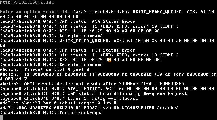

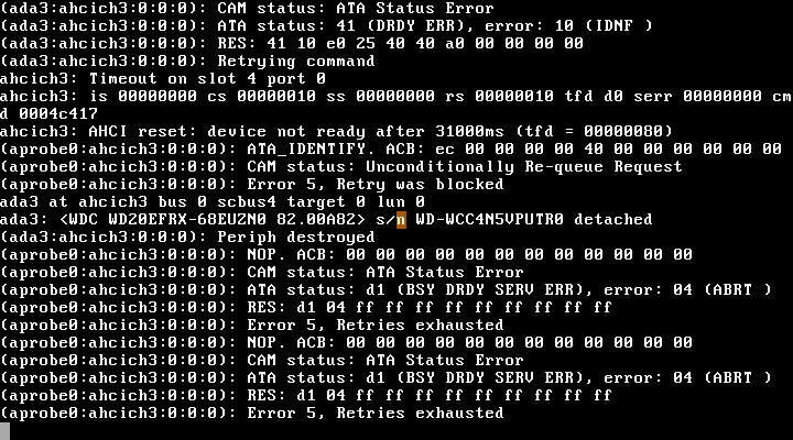

So I got the old disk put back in fine and reslivered. Went through and offlined the old disk, replaced it again with the new disk. But the errors I got in the console seem like my new disk that WD RMAd me might be a dud.
It's currently reslivering so won't know for a few hours but it seems as if the disk was rejected and removed when I went to add it in. Any insight would be appreciated. Hopefully I don't have to get WD to send me another replacement but I suppose that's better than having this one crap out on me in the next month or so anyway.

Either that, or it's a cable or port problem.
Just changed cable and port so looks like a bad RMA replacement. Being that it's a mobo of about 45 days old, I guess I was ignoring that possibility (and quite relieved it's just the disk.
