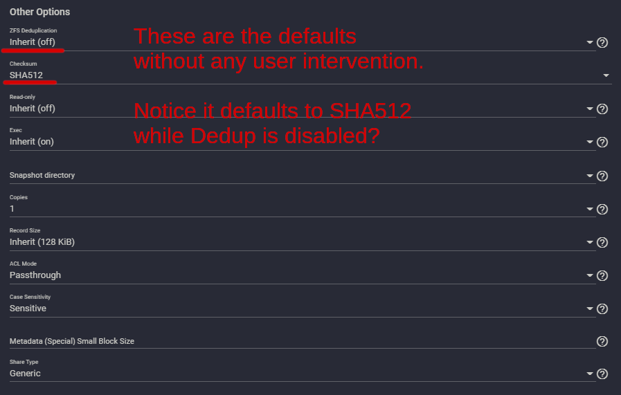

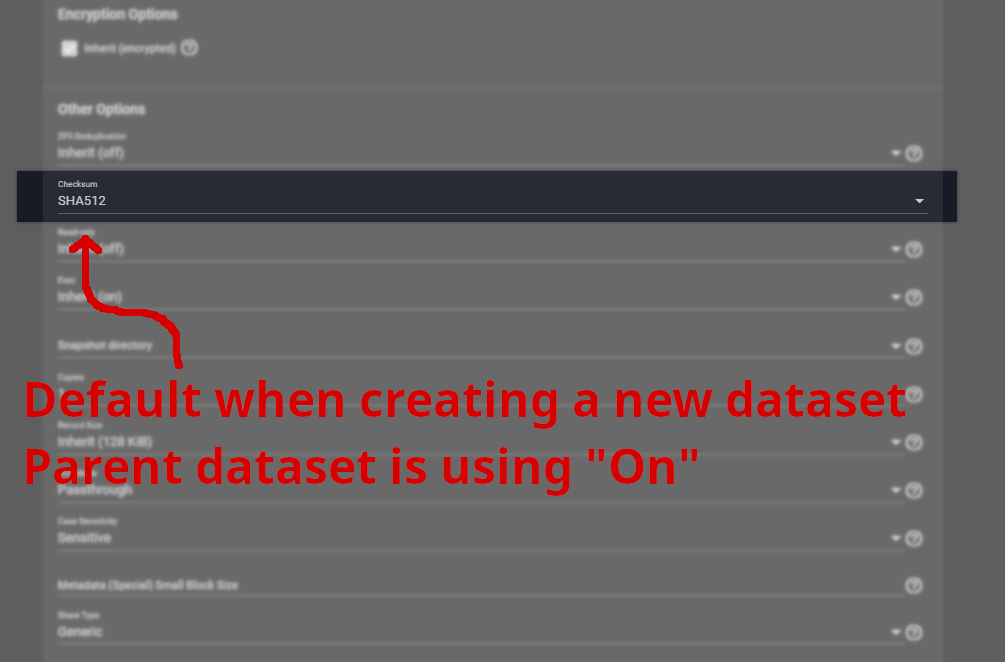

I just noticed that there is a Checksum option when creating a new dataset, and it defaults to SHA512.
All my datasets (created prior to 12.0-U6, and likely on 12.0-RELEASE) are using On for their Checksum option. (Confirmed with GUI and with console.) I'm assuming this is Fletcher4.

If you see my screenshot, this is the default selection for Checksum, and I'm not using dedup.

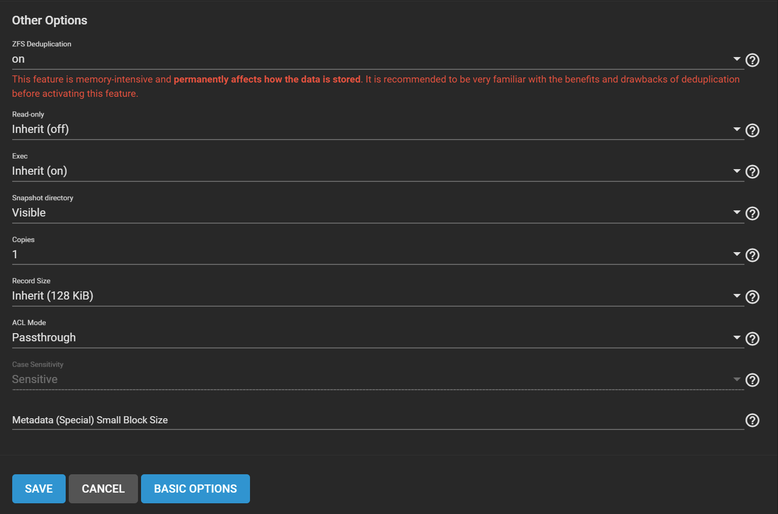

I think they made a mistake when implementing this feature. You get this dialog popup when enabling Dedup. (Just to reiterate: You only get this popup if you intentionally enable Dedup.)
I think the developers meant to only change the default selected Checksum if the user enables Dedup.

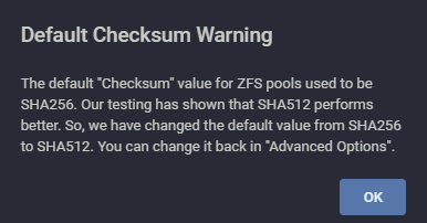

I updated the bug report with an additional required change: The wording of the dialog popup warning is incorrect and ambiguous
▼ ▼ ▼ ...Snippet from the bug report... ▼ ▼ ▼
On top of that, the dialog popup is incorrect, and must be re-worded to reflect a more accurate warning.
It reads:
"Default Checksum Warning"
"The default 'Checksum' value for ZFS pools used to be SHA256. Our testing has shown that SHA512 performs better.
So, we have changed the default value from SHA256 to SHA512. You can change it back in 'Advanced Options'."
default-checksum-warning-png.50206
This is incorrect / ambiguous / misleading for multiple reasons:
#1) Checksum is applied on a per-dataset level, not the entire pool.
#2) The default checksum for Dedup datasets was SHA256. The default for non-Dedup datasets always was (and still should be) On (i.e, Fletcher4). The popup is ambiguous and does not clarify this very important detail (of Dedup vs non-Dedup).
#3) The popup only appears when the user enables ZFS Deduplication, yet it makes no mention of Dedup vs non-Dedup in the warning. (As I explain in point #2 above.)

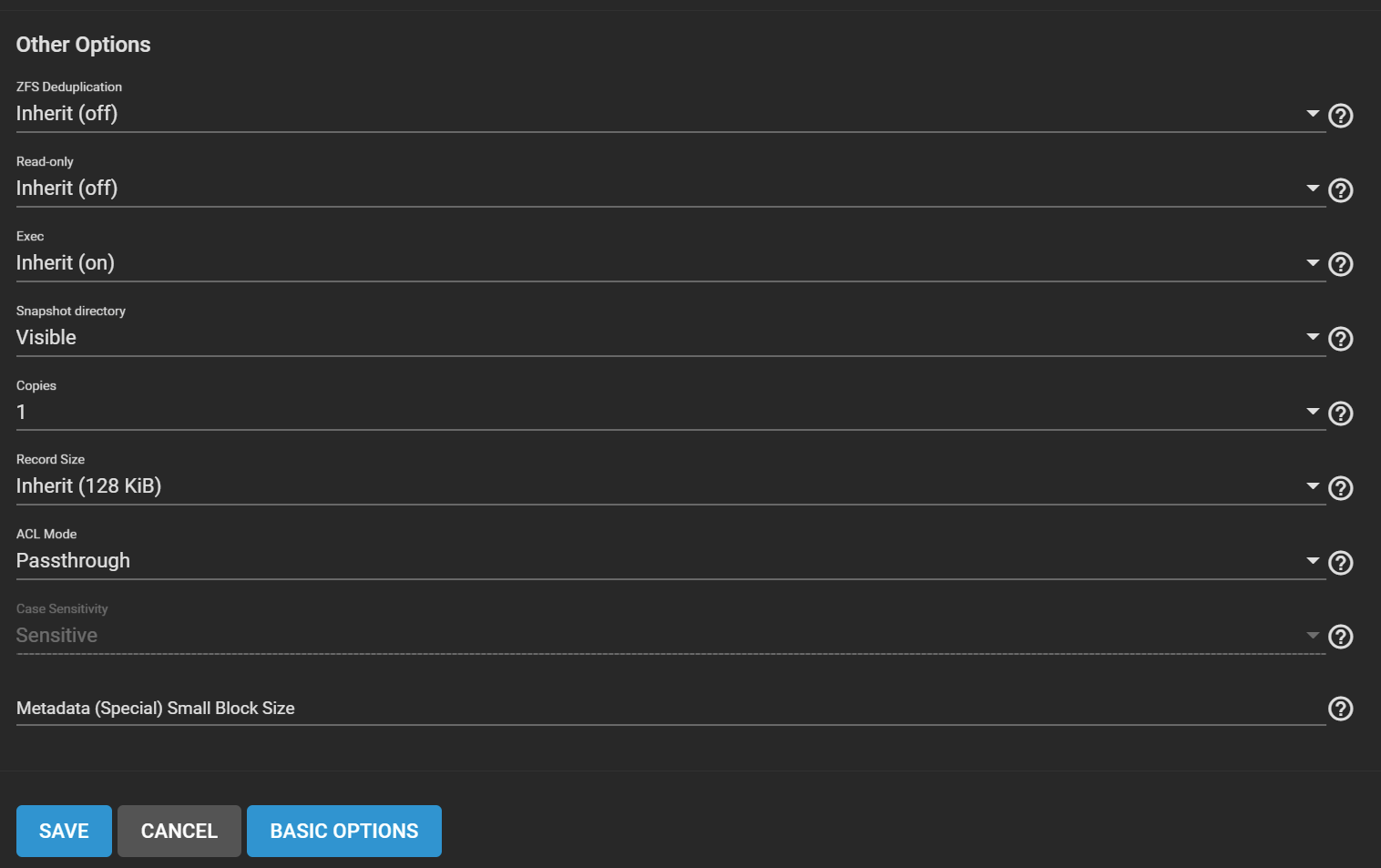

Hello, after updating to TrueNAS-12.0-U6.1 the checksum option completely disappeared from dedup and non dedup dataset.
Am I doing something wrong?

Please read the Release Notes for 12.0-U6.1. In particular, see https://jira.ixsystems.com/browse/NAS-113018. The default for non-dedup datasets stays at Fletcher4. For dedup datasets, it's now SHA512.
Yes, however, before the update I could change the checksum algorithm from the GUI, now the option has been removed completely.
I still have some non dedup datasets created with the previous version in SHA512 and I would like to be able to change the setting without using CLI.
zfs get checksum | grep sha512
This command returned to me dedup and non dedup dataset, probably it has been fixed for new datasets, however for existing dataset i cannot change the checksum algorithm with TrueNAS-12.0-U6.1 GUI thing which I previously could do.
Basically what I'm trying to say is that the checksum selection is completely gone from GUI.

Yes, this appears to be a deliberate design choice to remove the ability to change the checksum algorithm from the GUI. You'll have to resort to the CLI to change this.

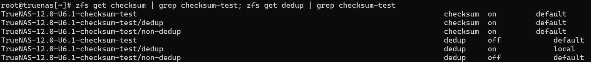

I did further tests and I think there is still something wrong, I created 2 new datasets in a new pool and despite being dedup ON the checksum remained on "on" instead of "SHA512"
"TrueNAS-12.0-U6.1-checksum-test" is the name of the new pool created 10 minutes ago

Go ahead and submit a bug report. It's entirely possible SHA512 was disabled as an option accidentally in this release.
