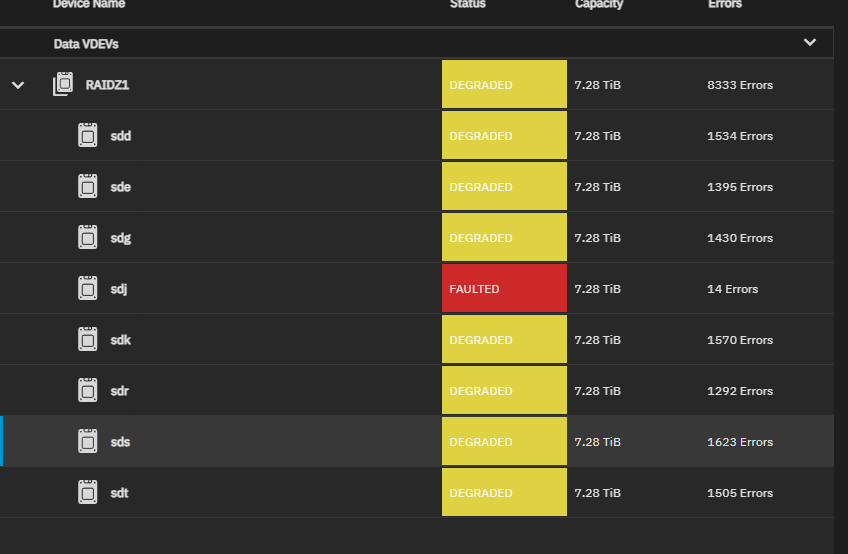

New build thats driving my crazy. SSD 870 QVO 8TB
neofusion
Apr 2, 2022
159
i would like to think there is another issue then the Toshiba drives themselves as i get no S.M.A.R.T indications at all...and that the SSD array is also reporting read errors even though i have removed the SSD that had S.M.A.R.T Errors
My troubleshooting so far,
i have replaced a HBA card with another (same model and FW)
i have replaced the 8087 cables that connect the backplane to the HBA
is there a chance that the backplane could be bad?
or is there a potential problem with the HBA (roadcom 9207-8i) and the drives?
I don't know how you got your drives and what adventures they enjoyed in their earlier life. Perhaps someone dropped the whole pallet and they are all actually broken? We will never know for sure.
My initial guess was the controller, but if you have tried different ones, ideally from different reputable sources while securing a good cooling solution for it, there's reason to start looking elsewhere.
I don't suppose you have a different system you could plop the HBA and drives into just to see if anything changes? It would help you deduce if you have a problem with the backplane, CPU or perhaps RAM.
I skimmed the thread again and can't find a full S.M.A.R.T. report, could you please post a report of one of the drives reporting errors?
It would also be interesting to see the output of: zpool status RaidZ2HDDx12

The drives are brand new.
I thought the HBA card was the culprit aswell...and still could be but i think there i a low chance of 2 in a row being bad.
I have a few HBA cards(E) with the same controller on it i could try.
its worth a try, i can change to an older chassis with slower backplane (SATA 3Gbps) just to see if the problem persists
Below is 1 / 12 drives that are repporting Errors

Hello guys!
This is my setup:
  • Supermicro 846 Chassi BPN-SAS2-846EL1
  • Asus x670E Creator
  • Amd Ryzen 7900
  • 4x32GB kingston 5600mhz cl40
  • 870QVO, x8, MZ-77Q8T0BW, RaidZ1
  • Toshiba 512MB 18TB, x12, MG09ACA18TE, RaidZ2
  • Broadcom 9207-8i SAS2308 6G SATA SAS HBA PCIe x8 3.0 LSI RAID IT Dell 0VGXKD
  • Onboard 10gbps
i finally bit the bullet and built a large NAS. everything has been going great until i just about finished the data migration from my old storage solution:
this is the SSD raid and this is the second time i install this setup and get the same result, lots of read errors (and only read errors)
I thought maybe it was the raid controller last time so i replaced it with a new one (same model thought)
Is there a known issue with Samsung 870QVO and ZFS?
Iam at a loss here, if there is this many read errors, can i trust the data that has been migrated?
what can i do to troubleshoot?

Update Time!
went through this list this evening:
#1Update BIOS, was on realease from factory...last bos releases "Improve memory compatibility"
booted up truenas and ran a ZFS clear pool. Did another Scrub and the errors kept piling up again.
#2 Hard set RAM to 4800Mhz
#3 Remove 2 out of 4 dimms
#5 switched out the 2 dimms for the other pair, Scrub is running and still no errors (only run for 20mins or so) but still a lot better then before.
will update with results in the morning after a full run

Yes it would seem that one pair of dimms are bad, or one stick of the pair is bad.
Right now with only 2 sticks of RAM in the system i no longer have read errors!
