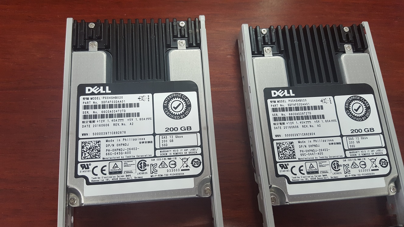

This is the one. I have them mirrored.
http://toshiba.semicon-storage.com/...oducts/enterprise-ssd/px04shb-px04shqxxx.html

Those are SAS 3 drives but you have them connected to a SAS 2 controller dropping the theoretical throughput by half - 6G versus 12G.

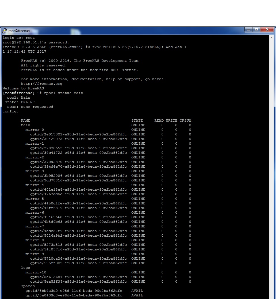

The following is my result.
Seems a little lower than your results, but dd performance seems to be fine.
Current pool setup is attached as a pic.
