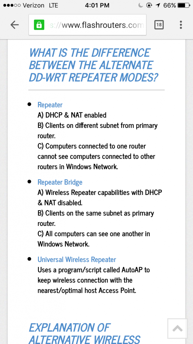

Okay so I'm going to do a temporary setup for now now while I flash the tp-link router. Is the repeater mode what I need for it to work with out the MiFi being connected? Thanks!

That depends, will the MiFi always be on? If not when it is turned off clients will not get a DHCP response so you will have to set everything to static IP addresses. Otherwise it will need to be able to act as a client and then give out IP addresses as a DHCP server to everything else.
I would suggest that you take anything else over to the dd-WRT forums or someplace more network centric to get this part of things straightened out since they will be able to work through the setup that you need. I have dealt with dd-WRT to a certain extent and have setup things to work the way you need but it can vary highly based on the router you have and they will be able to handle it better than we can.
