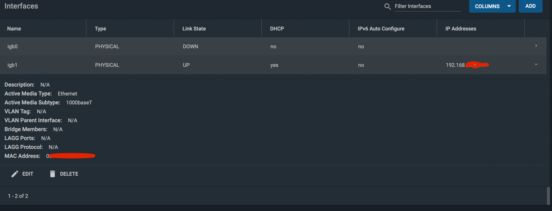

The LAGG was setup in "Failover" mode. But to help resolve the UP/DOWN/UP/DOWN/UP/DOWN nonsense I removed the lagg interface and disconnected one ether cable leaving one still connected as pictured on the post above.
pfSense has the static mappings outside the range. let me put up some screen shots for the rest of your requests..

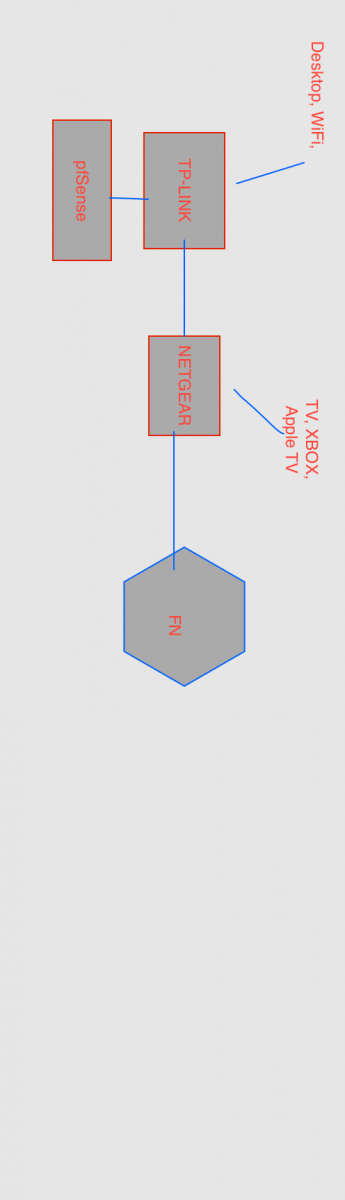

When was the last time you power cycled any of the unmanaged switches? You've got an unmanaged switch connected to an unmanaged switch connected to a wifi router (essentially unmanaged switch), they can get squirrelly and fail over time. I ask because you're not seeing the same behavior on the wifi network, which takes these other switches out of the picture.

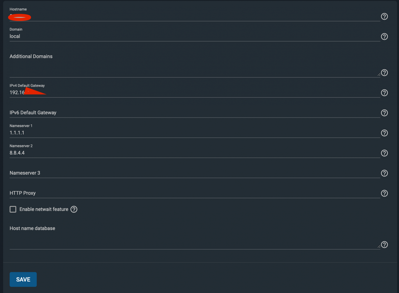

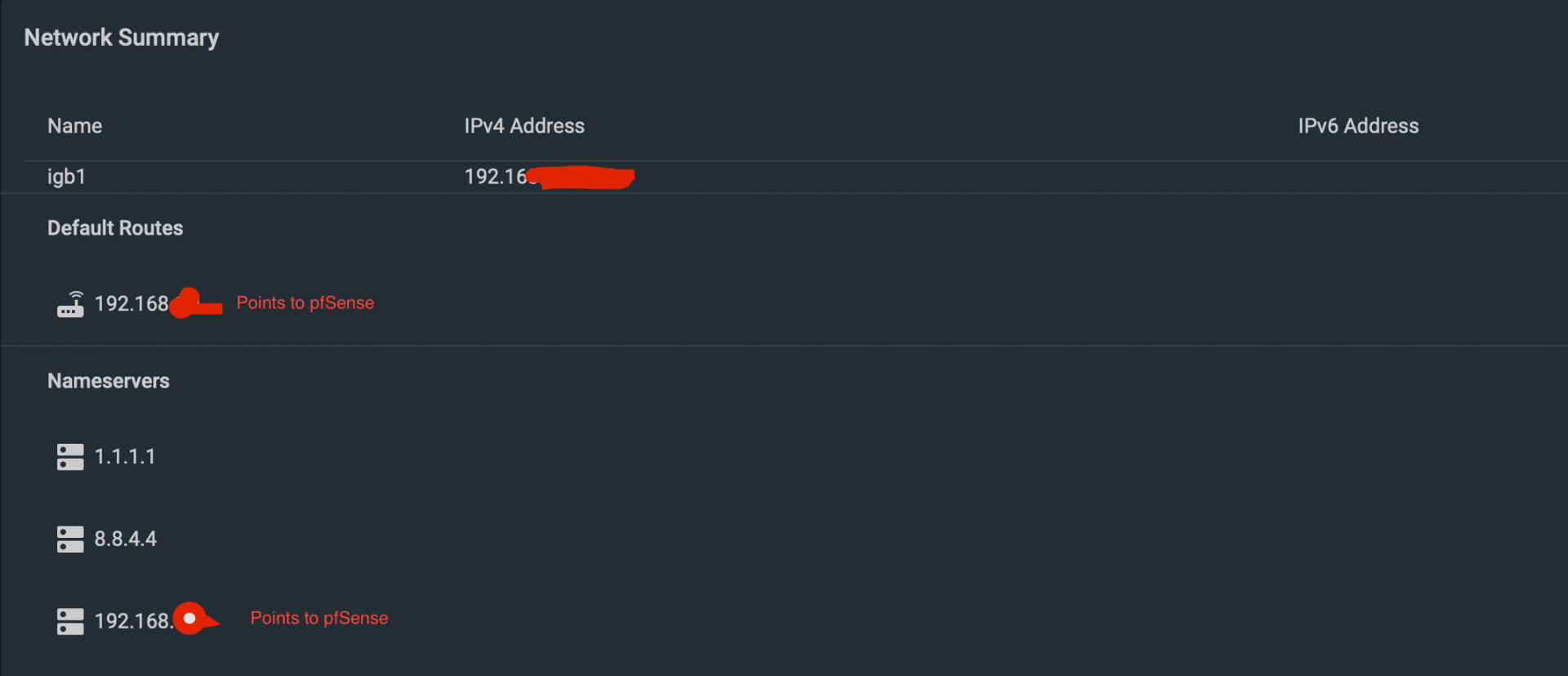

If will be helpful if you provide us with all of the details of your network setup for both your FreeNAS server and desktop workstation: static/DHCP? Netmask? Gateway? Nameserver(s)? Have you installed any FreeNAS tunables? Have you optimized the NIC settings on your desktop? etc.
Lastly, it may not be the source of your problem... but Intel NICs are reasonably priced these days, so I suggest replacing the no-name NIC you're using in your desktop.
No tunables
255.255.255
/24

Did some hardware troubleshooting.
All ethernet cables passed testing with an ethernet tester.
Long story short, I get 950mbits/s with one switch. Both switches individually work at the same speed. Now with the old setup FN-->Switch-->Switch/router-->Desktop it was slow. With FN-->Switch/router-->Desktop iperf gives 950mbits/s.
I need 2 switches to connect everything to network. Is it because the 2 switches are from different manufactures? What do you all suggest? The pfsense box has 2 more ports.
Thinking of connecting both switches to the pfsense BOX like below.
FN<-->Switch<-->pfSense<-->Switch<-->Desktop
Suggestions?
lmannyr
Oct 11, 2015
198
FIXED!
I replaced the TP-Link Switch with a spare 4 port Netgear switch. Speeds are 950Mbits/s both ways.
Kept the old hardware config since the other 2 ports on the router seem to not be working (lighting strike a few years ago).
I appreciate everyones time and input.
