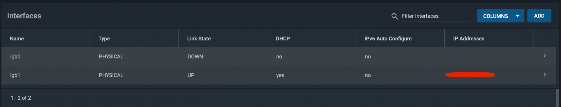

OK, we might just want to confirm it and run dmesg | grep igb but it looks like that may not be the case at the FN end.
Check on the switch (maybe with a green/yellow light indication) if it thinks it's 1Gbit or 100Mbit.
Are you using both NICs?

"Pro/1000 Network Connection" is Gigabit right?
All lights on both switches are GREEN.
9,700
And there we have it... your LAGG is flapping (or are you just unplugging cables?).
We need to look at the config you're using on FN and on the switch for that.

Your FreeNAS interfaces seem to be going up and down, which isn't good. And it looks like you've configured a LAGG group? Try removing the LAGG group and see if you can get reasonable performance from a single interface.
EDIT: definitely remove the LAGG group; you're using unmanaged switches and LAGG requires LACP support and configuration on the switch.
If will be helpful if you provide us with all of the details of your network setup for both your FreeNAS server and desktop workstation: static/DHCP? Netmask? Gateway? Nameserver(s)? Have you installed any FreeNAS tunables? Have you optimized the NIC settings on your desktop? etc.
Lastly, it may not be the source of your problem... but Intel NICs are reasonably priced these days, so I suggest replacing the no-name NIC you're using in your desktop.

And there we have it... your LAGG is flapping.

You have a lagg configured and connected to an unmanaged switch. Problem solved...
The LAGG was added to help solve this issue. LAGG was setup as "Failover" as recommended in the manual. It didn't help. For S&G, I deleted the LAGG from interface, and disconnected one of the ethernet cables from the FN box. Same results with iperf.

No, we would need to see a screenshot of what you have under Network | Interfaces... but maybe you're already changing that to remove the LAGG, so no need if you've done that.

That wouldn't have been the case even with a managed switch, so it's good that it's now off the table.
I think we should still look at how it's set then.
9,700
If you're not using the server for anything, I think it might be time for a reboot after having messed with LAGG.
All of that UP/DOWN noise has happened since the last reboot, so it would be nice to see dmesg come up clean.
