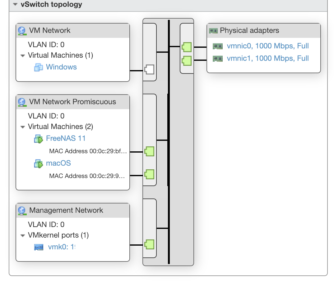

I have esxi box with lan configured VM Network Promiscuous network and... like i said when i used the warden jails i had no problem, nothing else changed in mij freenas setup.

ESXi 6.5 running freenas 11.2 with 72Gb ram and 12 cores @ 2.1Ghz. Using a Supermicro board with 2 intel nics with (i think out of my head i350 chipset....) in lagg in ESXi without any problem in other osses.
Running freenas in esxi in a Promiscuous virtual network with static ip, using my inetrnet provider's dns, al worked perfectly in warden jails.
At some time in idle it seems to loose connection with the jails, this never happend before, some jails will comeback without any issues some will not come back with a connection. Like plex it takes like 3 or 4 minutes before it has it connection bak, and NZBget i have to restart a couple of times to get a connections, also couchpotato has a lot of issues.... sometimes after starting the jail it can not connect at all. that is why i have a dummy jail. Sometimes i start that and stop it and then restart a not working jail and.... it gets a connection... strange i know.
I have this problem since i switch to the new jails in 11.2 before i always used warden jails, but everyone here keep sayng i need to switch.... well i feel stupid i did because i have more trouble then i ever had, and also updates for instance for plex are still very slow, not faster and better then on warden jail was.
When i have problems i can not ping to anywhere even not in my own home network.

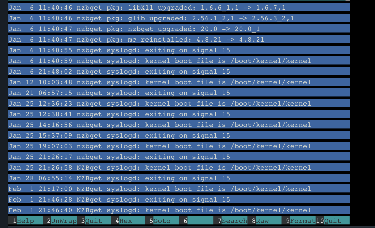

Also found another strange bug when trying to use shell (in the web interface not SSH).... when connecting with the IP address or using freenas.local it works, but when using freenas.DOMAIN shell does not work... it did before in 11.1 and before....
Attached the log from one of the not working jails
i will lookup the log file

SweetAndLow
Sweet'NASty
Nov 6, 2013
6,421
Everything in your logs look like a normal boot process. Can you describe what you mean by the jails lose connection? Like can they ping stuff on your network or can stuff on your network ping the jails? Or does the service just not work? I think this has something to do with your virtualization of freenas.
