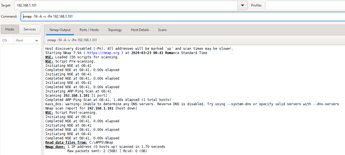

More tests, with Nmap which says that "0 host up" :
On Windows side, tried cleaning DNS (ipconfig /flushdns), cleaning ARP (arp -d *), reset TCP/IP ("netsh i i r r" and "netsh winsock reset").
Ping from NAS to Windows lost all packet.
Ping from Windows to NAS says "Destination host unreachable / Request timed out"
Should I redo the same tests with crossover thernet cable or consider my hardware broken, call it a day and search for a way to recover my data ?
Thanks again and again for any intel on the subject...
