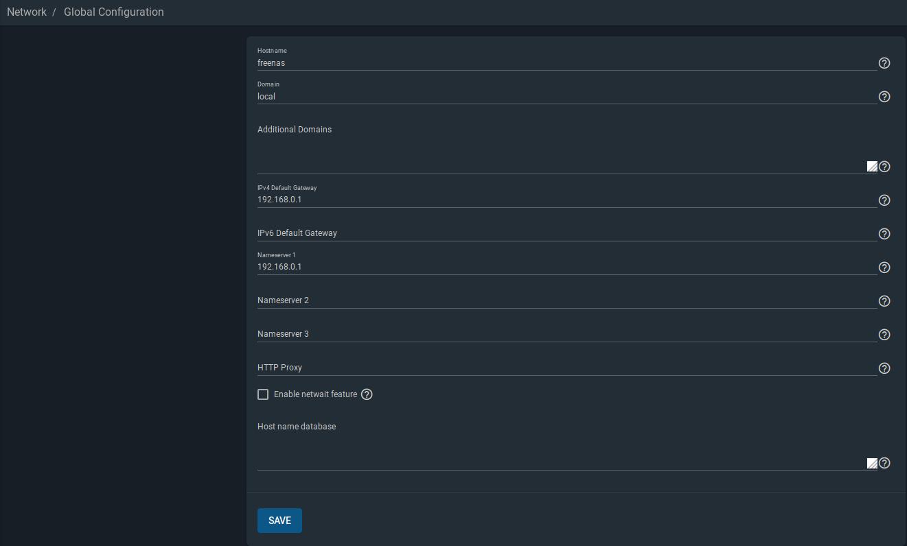

Let's start with a screenshot of the FreeNAS UI Network > Global Configuration

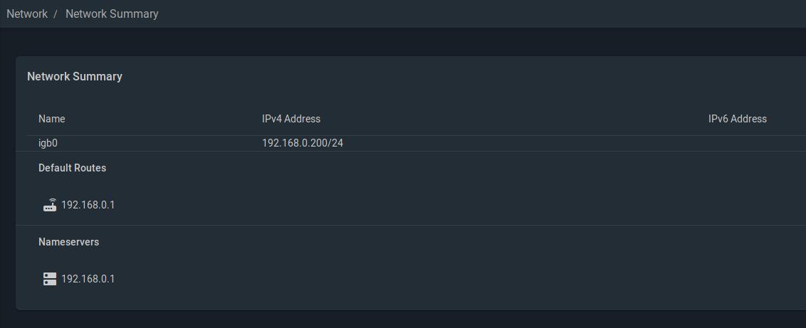

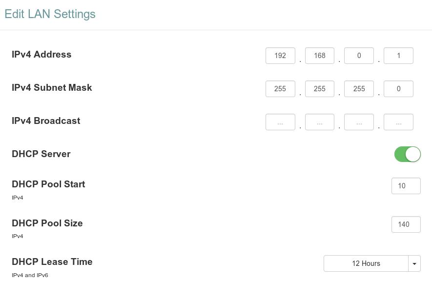

As a test, try setting Nameserver 1 as 8.8.8.8. We'll see what happens and then revisit.

@Bjureus1 - one other thing that may-or-may-not make a difference is that on your router you seem to have a null broadcast. Try setting that to 192.168.0.255

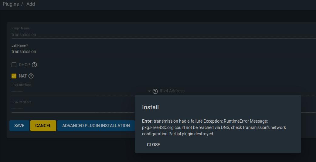

Receiving this message when trying to install transmission:
Install
Error: transmission had a failure Exception: RuntimeError Message: pkg.FreeBSD.org could not be reached via DNS, check transmission's network configuration Partial plugin destroyed
Install
Restore it back and try @Newfoundland.Republic's tip about the null broadcast.
