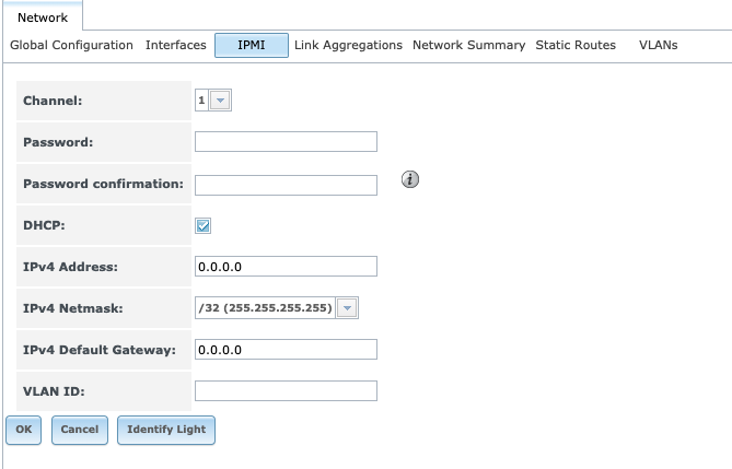

EDIT: Under "Services" I see "Dynamic DNS" disabled, should that be on?
Also IPMI Tab is set to IP4 0.0.0.0 see screenshot

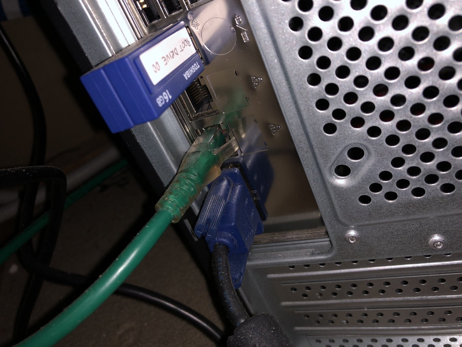

my bad I was looking at the MB in a vertical position inside the case, yes lights are flashing and I can access files and use the freenas on local network, and the cable is connected to one of the two ports side by side
see picture attached

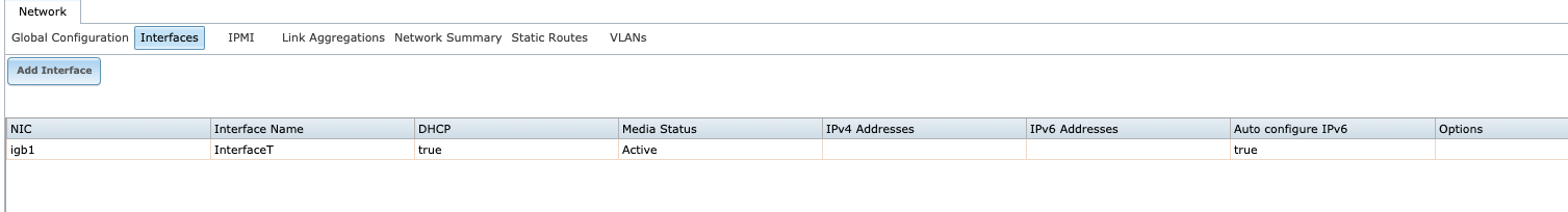

What does Network, Interfaces show? BTW, what version of FreeNAS are you running now?

I've attached a screenshot of the interfaces
I'm still runnning 11.1-U7 , if I try to check for updates I get an error

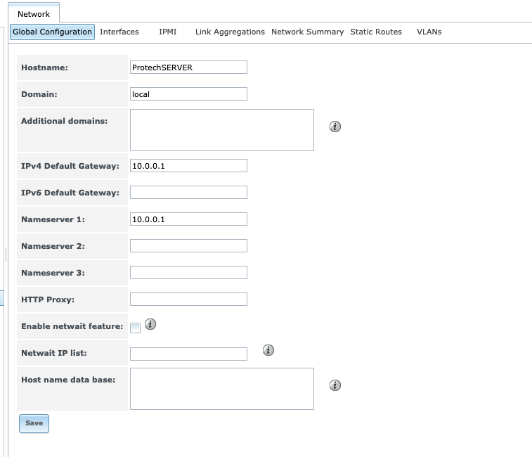

Why is IPV6 showing true? Please screenshot Global Configuration.

IPv6 is showing true as ticked the "autoconfig IPv6" box to try, If I turn it off (false) makes no difference
I've attached the screenshot. I honestly don't know what else to look for

OK, so the IPv6 is a non-issue, only one DJCP server, looks like the arpresolve message is a report of something that your router is not properly flushing from its memory (maybe it should be rebooted...).
Long shot but worth a try, I think - repopulate the Global Configuration page with your router IP in the IPv4 gateway and all three Nameserver fields, save it and reboot FreeNAS - then also check that there's nothing spurious in Network Summary.

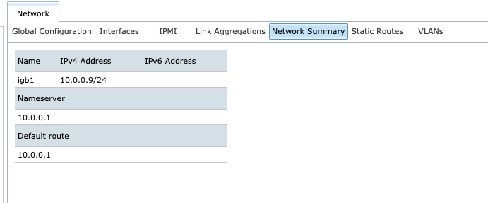

nico3
May 23, 2017
31
Router got rebooted multiple times. I've updated the global config with router ip in all 3 nameservers but in the network summary is only showing one (screenshot attached)
I've also rebooted freenas, no changes
BTW thank you so much for your help troubleshooting!

On the IPMI issue on the other ports - depends on configuration choices - jumpers on mobo and bios settings - you should look at the back of your mobo manual and also get the IPMI manual from SM for your mobo series.
