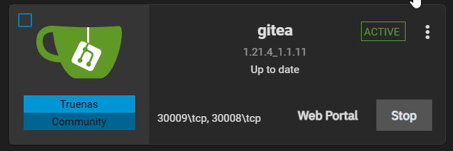

Installing gitea from available apps TrueNAS-SCALE-22.12.4.2 (btw, complete noob in git, but cannot even attach 2 web portal).
Two questions:
How 2 setup correct root URL? was setting http://192.168.x.x:30008/gitea - no connection or entering TrueNAS login screen. BTW, may I set another IP 4 the pod?
Maybe the problem is in directory permissions
For making backup easier I created 4 directories, made chown 2 apps (please, see below)
Postgres made chown during install, but other dirs untouched - should I chown them 2 docker? DB iwas running, according 2 the log, btw
Waiting 4 advice
BTW, app was active during 1-2 min, but now is in deploing 1/2 state again...

Partially solved, after watching default install data I repeated directory structure with permissions below
drwx------ 2 1000 1000 3 Jan 24 10:02 config
drwxr-xr-x 15 1000 1000 15 Jan 24 10:07 data
drwxr-xr-x 2 root root 2 Jan 24 10:01 pgBackup
drwx------ 19 999 docker 26 Jan 24 10:01 pgData
r-x on data was set by me 2 watch config
Now web UI is shown (I set only IP:port w/o /gitea postfix) howevew postges does not want 2 start, if placed not in ix directory.
listening on Unix socket "/var/run/postgresql/.s.PGSQL.5432"
2024-01-24 09:37:45.479544+00:002024-01-24 09:37:45.479 UTC [108] FATAL: password authentication failed for user "gitea"
So cannot guess default password. How happens, that it cannot run from different place? I don't want to have data on SSD apps pool, especially database. Advice needed...
BTW, how it managed 2 work differently - only db path changed....

Was needed to re-enter all the directories and clean them manualy - works now. Seems, that reinstalling with default paramerers normally overrides previous DB password, but not changing with customized path

1. Create the directory structure by mv\chmod\chown, exactly as in post #2
2. If it's already done, but no success - uninstall with removing docker image (maybe, not needed, in case)
3. Before next install do chmods 2 enter all directories mentioned and clean all in them.
4. Map the directories accordingly during fresh install
IMHO - Postges and other directories cleanup is performed only with default settings.
