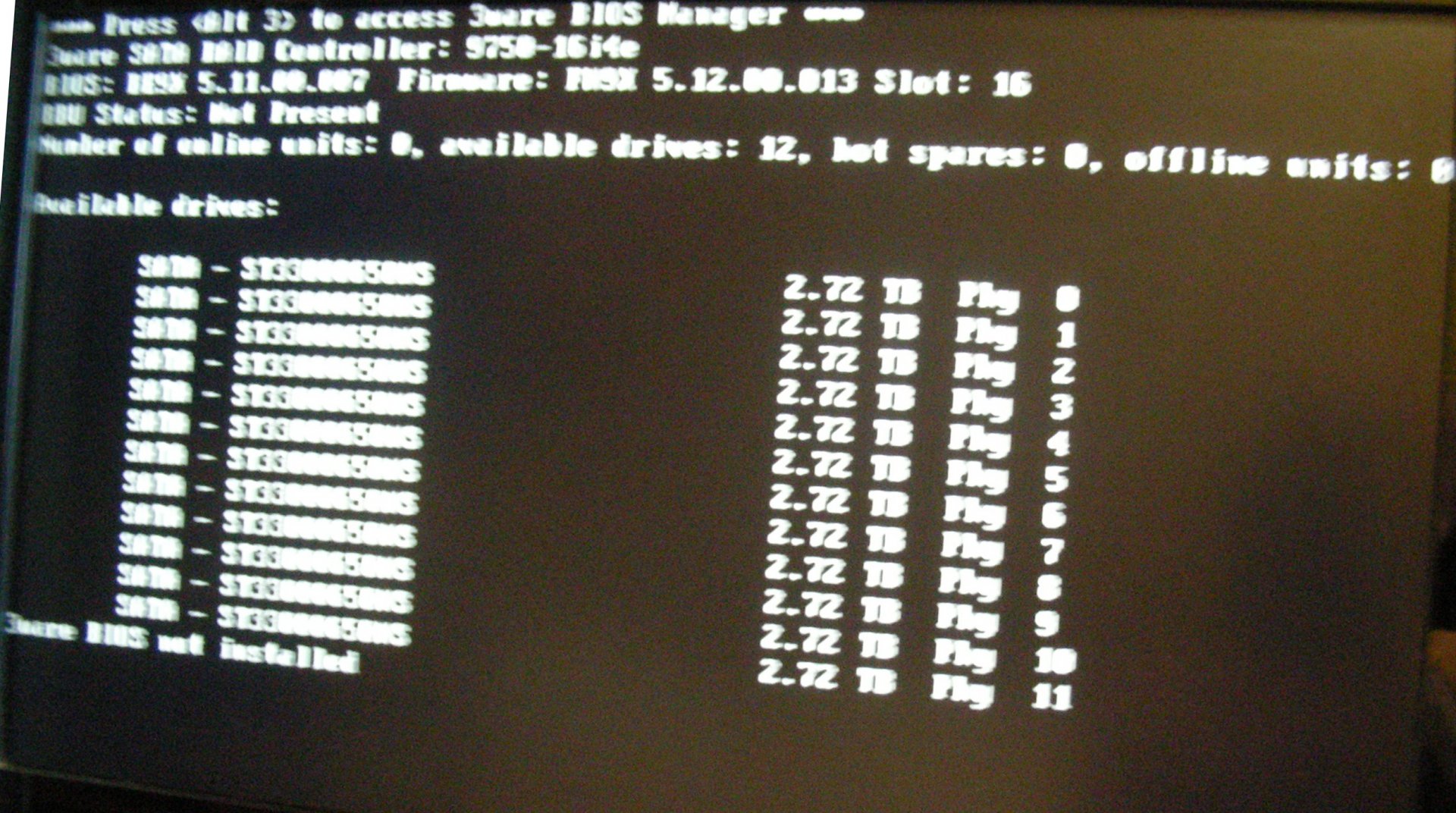

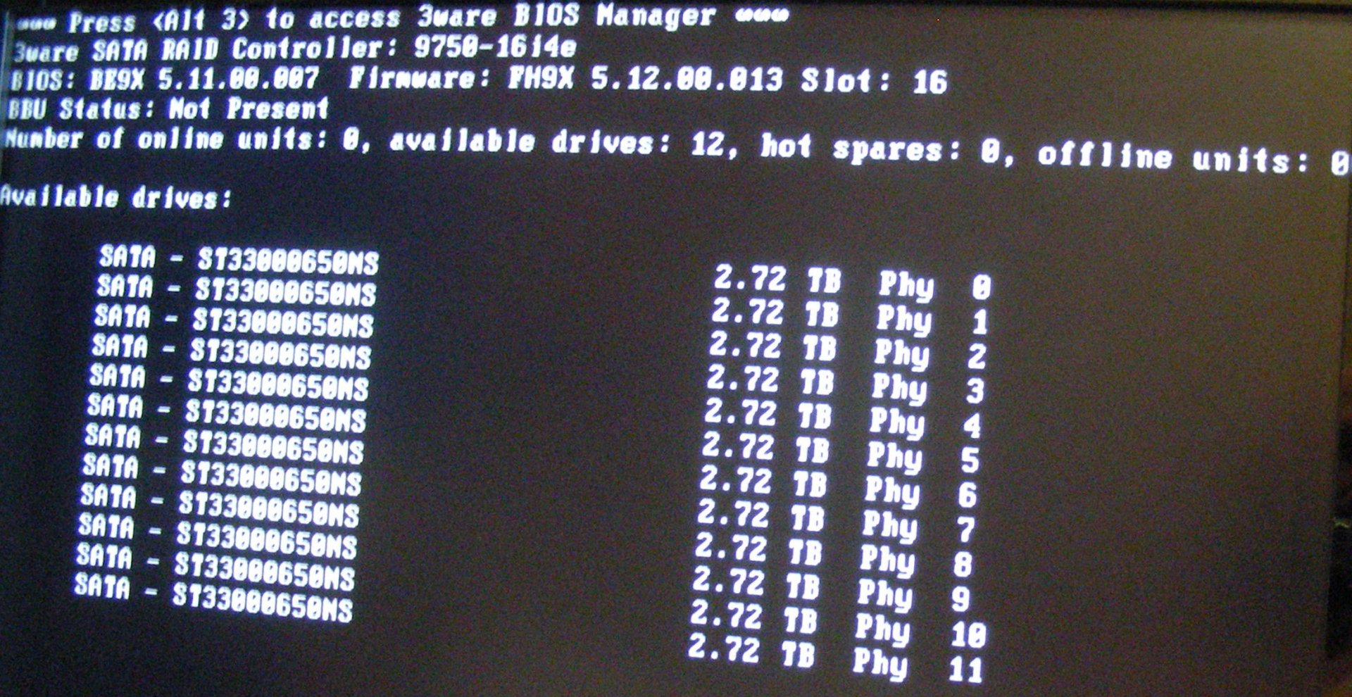

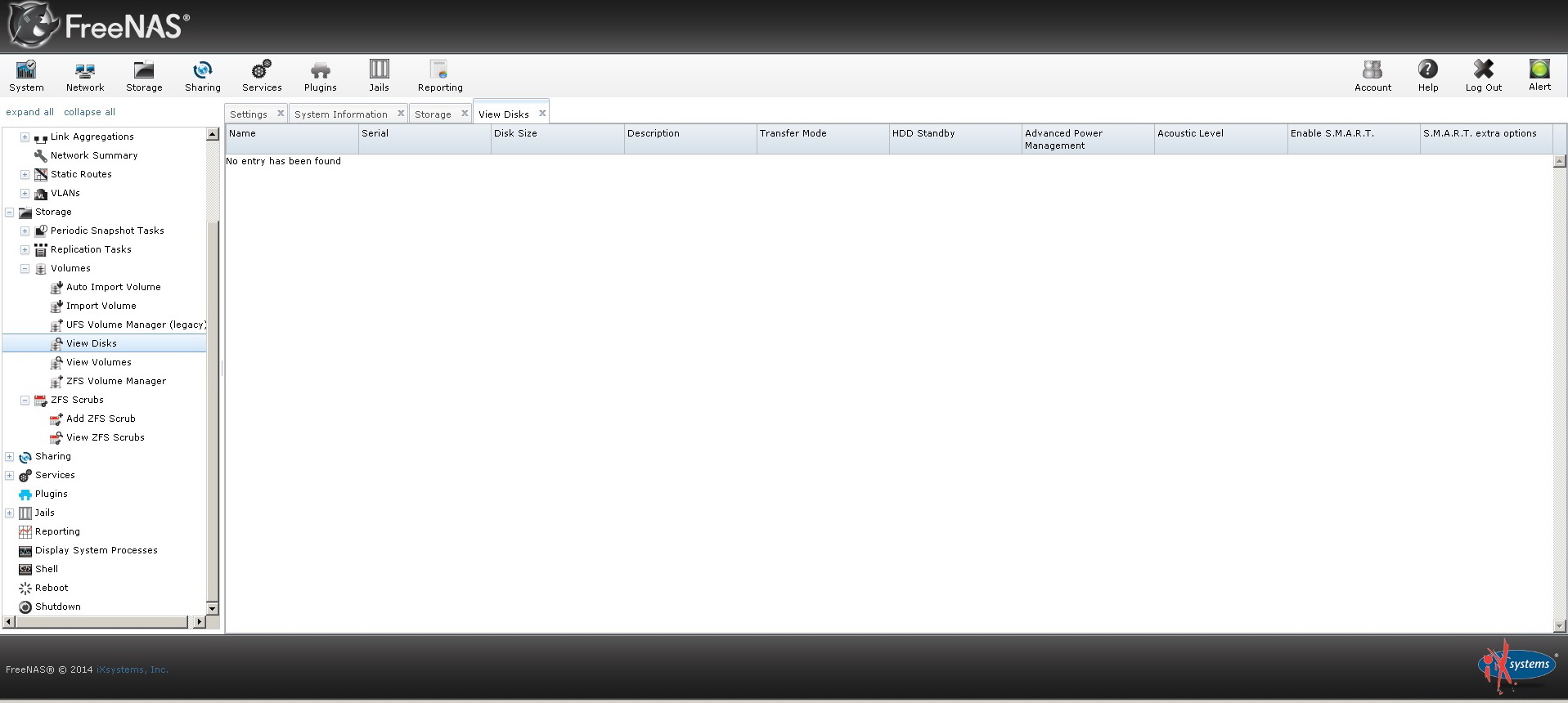

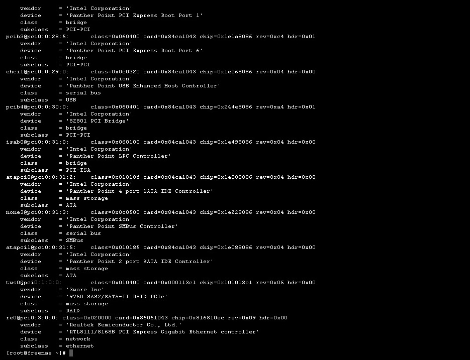

Thank You for Your answers! So, I've Installed FreeNAS and the new story has begun: 3ware BIOS sees all HDDs(scr. 1&2, I've read that 3ware controllers says "BIOS not installed" if RAID not been mount on it), WebGUI sees no HDD(scr. 3), shell command "pciconf -lv" sees 3ware controller. I've upgraded 3ware BIOS firmware, updated 3ware FreeBSD driver, run various commands(found in internet) in FreeNAS shell & don't know what else to try.

You need to configure each disk as a single disk unit in the 3ware bios before they will be available to FreeNAS. I'm not sure if that controller will properly pass SMART information to FreeNAS.
HoneyBadger
actually does care
Administrator
Feb 6, 2014
5,112
It won't. That 3ware card doesn't support IT or passthrough mode for drives; it will only present a bunch of single-disk arrays.
ZFS + RAID equals problems, whether it's poor performance or a dead zpool down the road; I strongly suggest getting an HBA and ditching the RAID card, as well as following Drake's advice.

Thank You. HoneyBadger, I didnt know about that, I thought that all RAID Controllers work as HBA (SATA-SAS Controllers that I used before could.) I've just installed 16GB of RAM (DDR3, Non-ECC). I think I'll buy LSI SAS 9201-16i Host Bus Adapter.
