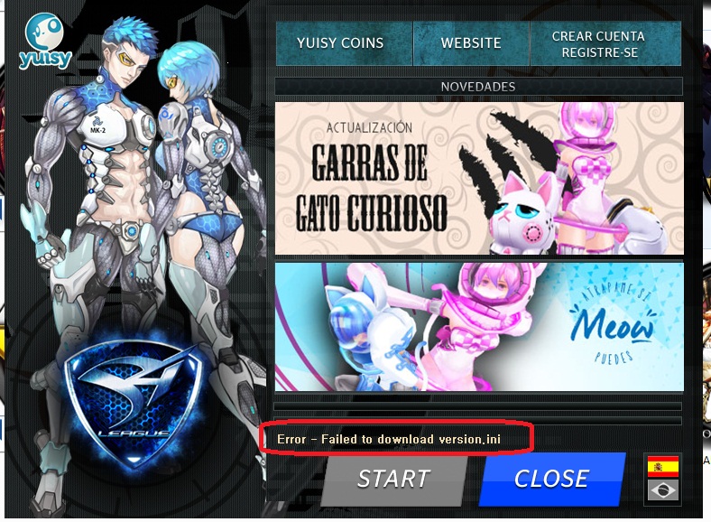

i have no support in my country
i install freenas
on t7500 dell in my netcafe
4 * 1TB RAID 0 + 2 SSD 128G/ l2cash / 16 GB ECC RAM CIFS share

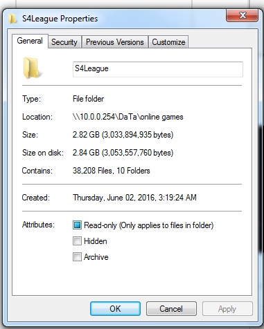

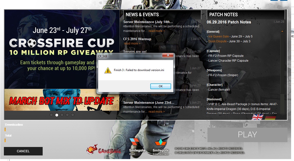

suddenly programs and some type of on-line game that need program read write function cant exquisite

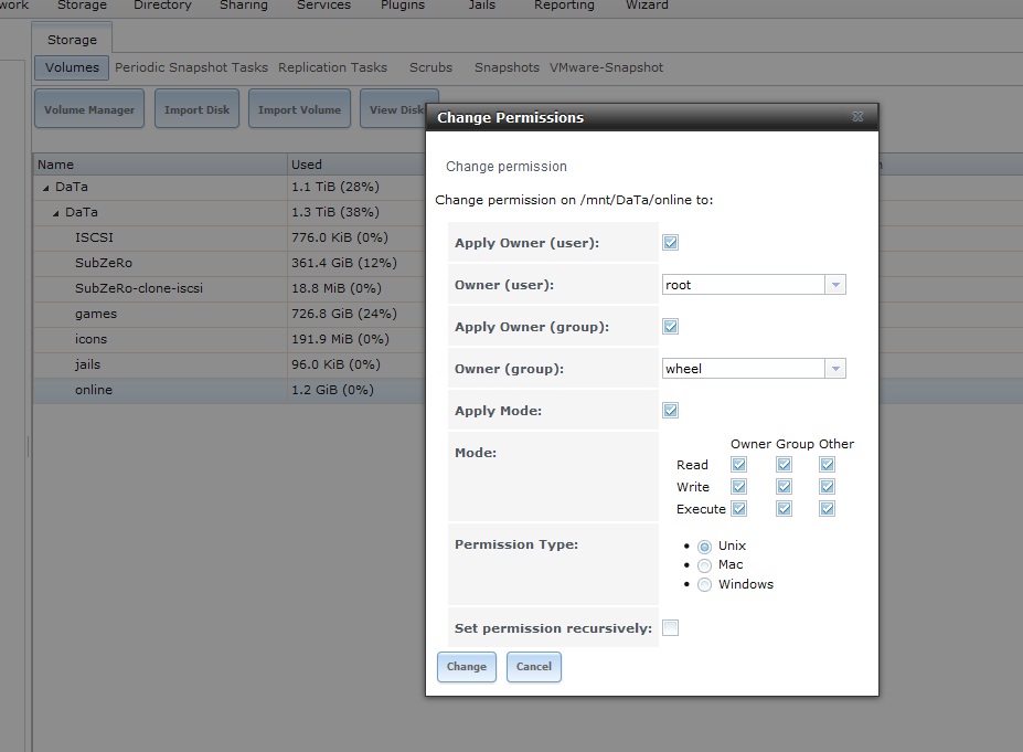

on shell permeation R 777
i don't know what to do or who to ask for help

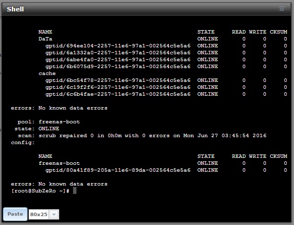

Please run "zpool status -v" and, post the output here in code tags (makes it easier for everyone to read).

I know there's something of a language barrier, but please try your best to use capitalization and punctuation. It's extremely difficult to parse your partial and run-on sentences.
It looks like your pool and all your drives are online, so that's good. However, you cut off at least part of the output. Can you make and post a debug (using System -> Advanced -> Save Debug)?

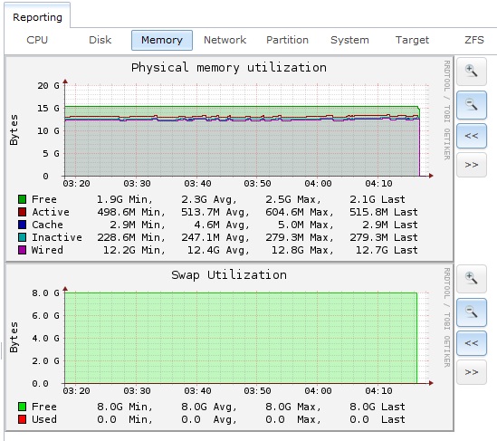

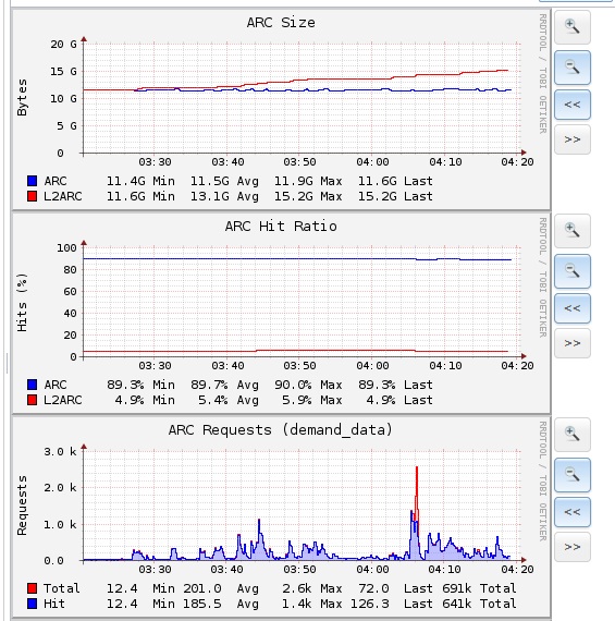

For starters, with only 16GB of memory, having one L2ARC drive is overkill at best, or actually hurts your performance at worst. Three is way beyond overkill, and most likely is hurting your performance.
I'm trying to understand this:
unfortunately my work count on this server i run 24 PC online games like crossfire and lol from it cfis share (first net cafe)
second one i run 32 pc)
Are both your net cafes using this one FreeNAS server? Or do you have one at each location? With 24 simultaneous clients, I'd personally recommend more memory. How's your memory use and ARC hit ratio?

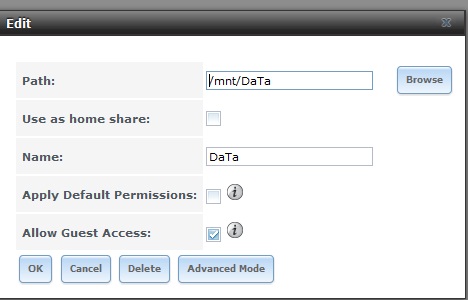

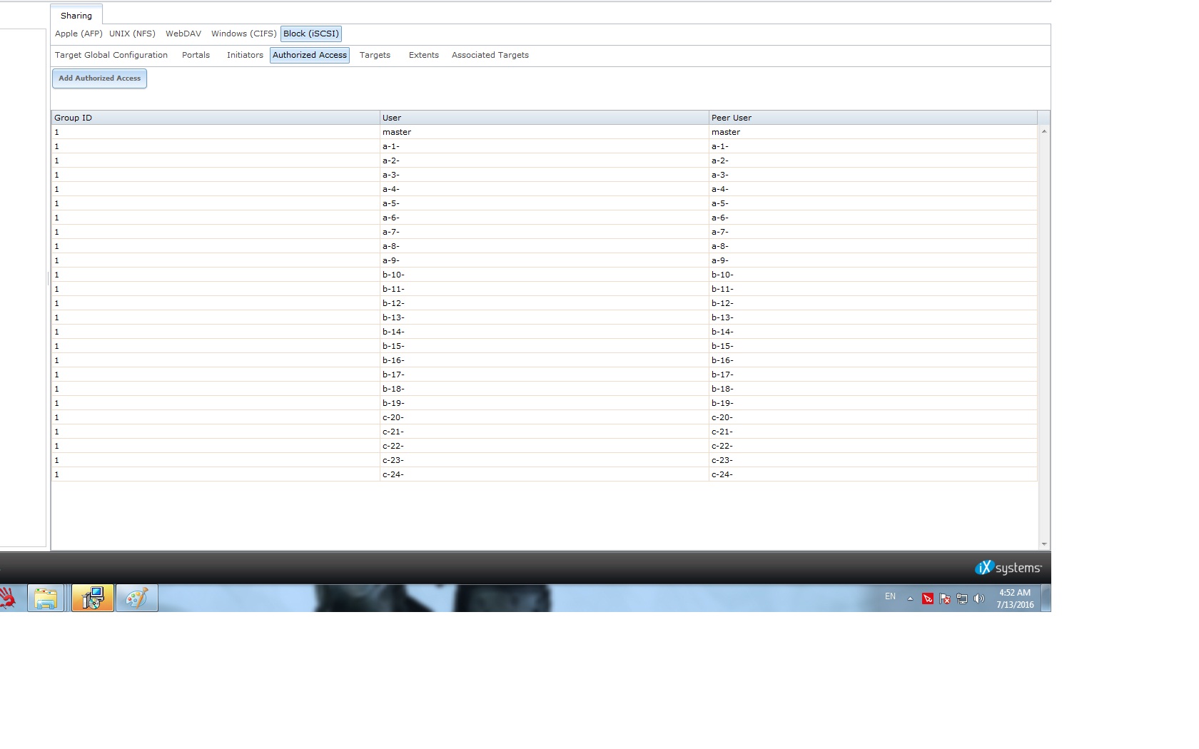

So, there are two other things: (1) exactly where and how did you do a "on shell permeation R 777"? (2) what exactly are your error messages? Are you getting any errors on your FreeNAS console?
On the iSCSI issue: you can't simultaneously share an iSCSI mount with multiple machines (at least not without special software). Based on what you've said, I think that's what you're trying to do. If I understand you correctly, you are sharing game files for multiple PCs from one central server. If that's correct, I'd say a CIFS share is your best bet.

HDD : 1TB X4 I USE RAID Z TO CREAT IT AT THE FIRST TIME
Based on the screenshot you posted, it looks like you actually striped all four disks together. If so, you have no protection against corruption or disk failure, and should seriously consider destroying the pool and starting over.

4. Configure a single dataset with windows permissions and cifs share with guest access only configured.
5. Make sure owner for dataset is 'nobody' and group is 'nogroup'.
i don't understand is it a good thing or a bad thing and what should i do ?????
about performance i guess it work well , all net cafe work from server in the same time (24pc) for more than 18h a day at good performance

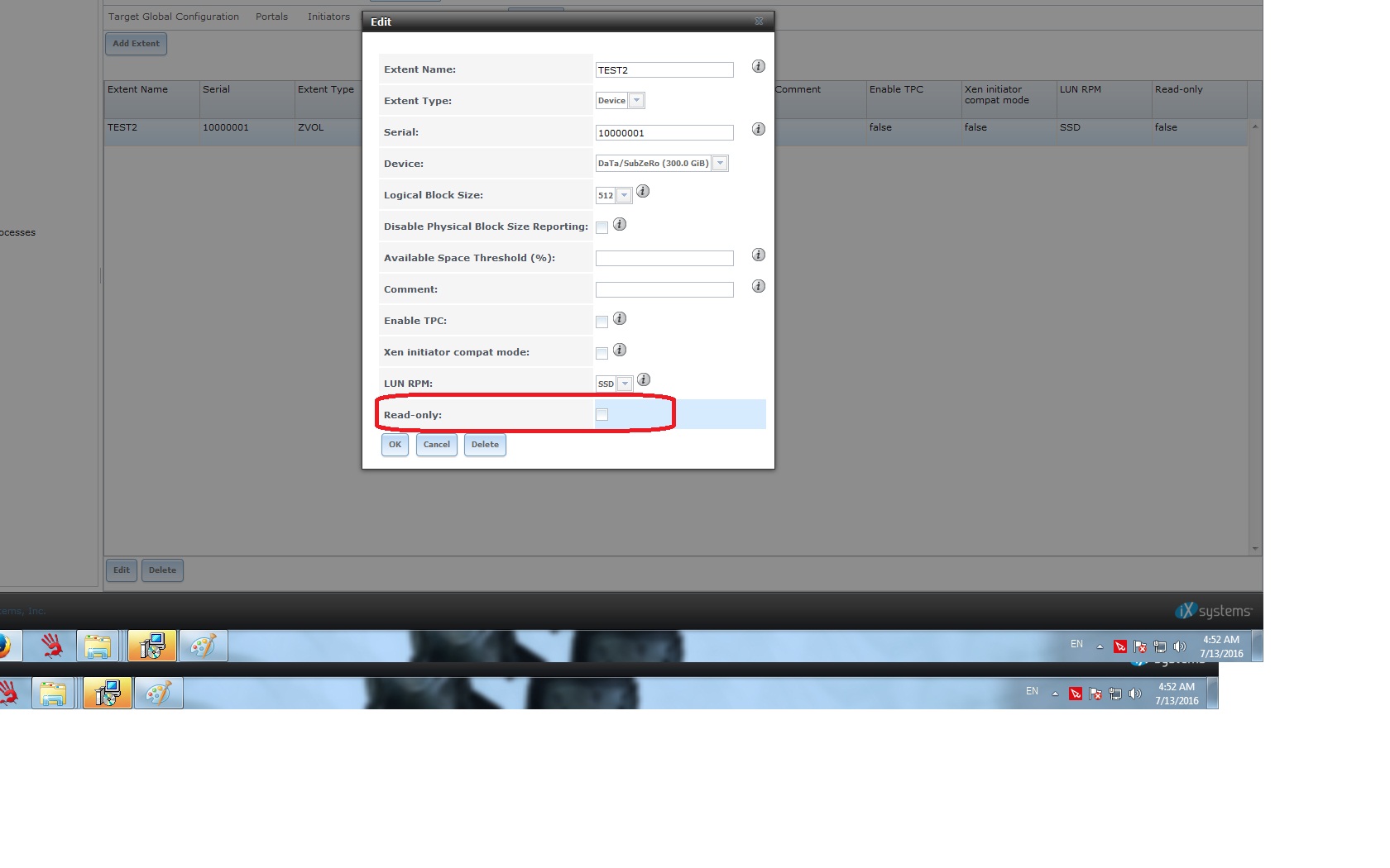

some games didn't support to excite on multi PC like crossfire arx privet server, so i use iscsi partition, but it always crash and i cant make it read only because most of online game need to read write

its all about read only permeation some online games cant update it self (program cant write ) and i don't know how to solve it .

Regarding permissions, if you're using CIFS sharing, chmod everything to 777 is not the correct approach. You should set the dataset to Windows Permissions, with suitable ownership at the top level, then do everything else via Windows security settings.

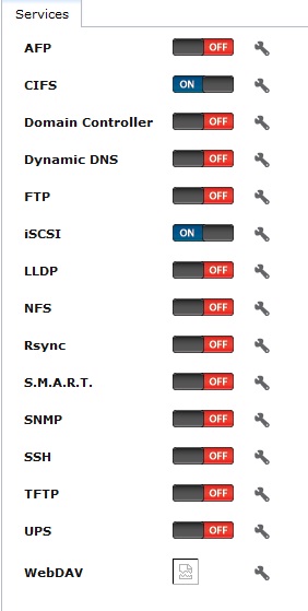

  • Your pool has no redundancy, therefore no protection against corruption or disk failure. You should rebuild it as striped mirrors if you plan to continue with iSCSI.
  • You don't appear to be running regular SMART short and extended tests, and you have SMART monitoring turned off, so you'll have no warning when a disk starts to fail. Fix these and make sure you have email alerts working.
