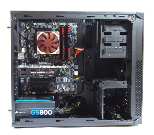

1) Is there any issue using the 5 Toshiba 2TB hds? They are brand new and never powered on, and he'll run a deep check on all of them before putting them into use.
2) I told him he could simply use a good external flash drive to boot FreeNAS off. He wants to use the old SSD. I've searched the forums and have seen some slight performance enhancements, but it seems like a waste of his SSD.
3) Main issue I have, hard drive heat and lack of space. The Ts140 case has room for 4 hard drives, if you strip everything out. He wants to either....Option A): use the 3 bays in the TS140, and jimmy some rack that sits on the bottom of the case with the other two hard drives and a fan. Option B) Make use of an old Corsair 200R case. This has 4 3.5" slots, and room for a few expanders in the 5.25" bins (there is 3 5.25" slots) for the last hard drive. However, reviews I've read claim horrible heat issues with how the 4 hard drives are situated on the bottom.
Here is a picture to illustrate:
Honestly, both Option A and B seem like dumb decisions to me. I can't seem to convey that point to him. I think he knows its not an optimal setup case wise, and I'm pretty sure he is trying to save as much money as possible. He has a young autistic daughter (who loves watching movies and shows off Plex so I think that is why he is building this) so I understand why he is trying to skimp and keep costs low. Do both these options sound as bad to everyone else?

As I understand it, putting a fifth drive in the optical bay is a common hack in the ts120. Providing cooling is taken care of.
Using a 120GB SSD is fine/sensible
Using 5 drives in Raidz2 is sensible.
I see no issues with your colleagues build.

Maybe for gamers and CPU and/or GPU intensive uses, heating can combine to the drives' heat and create those problems. Can be alleviated by adding fans where possible.
The Corsair looks really well vented with mesh all over, even on top; I can't see why using it would be a problem. Maybe put three drives on top and two below.
I've played with various off-the-shelf systems with hard drives installed other than where the engineers intended, and I've come to the conclusion that it's a mistake, for exactly the reason you suggest, i.e. cooling. My advice would be, if a system is designed for 4 hard drives, don't buy it planning to put 5 hard drives in it.
This leads to Option C: build with 4 storage drives, as the Lenovo engineers intended. Cooling issues with an SSD in the optical bay won't be an issue.
This is not to discount Option D: use a different case.
