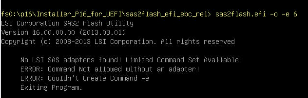

Edit 2: When I issued the first command - Ugh - I got this ???:
There IS a LSI MegaRAID SAS 9240-8i 6 GB/s 8-port SATA+SAS RAID Controller installed. And if I boot into FreeNAS, it has no problem mounting my healthy pool on drives that are all plugged into the Controller. So what gives?

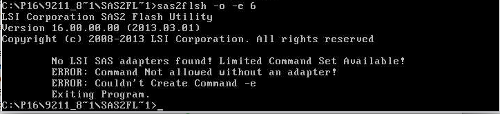

I tried it in DOS and got the exact same error:

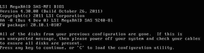

But the LSI BIOS is loading:
I'm pretty much out of ideas now and google is not helping. I find other people who had the problem, but no resolution, except one guy who did it in DOS after UEFI and then it worked. I need help!

You could try a different version of sas2flash. Maybe p20? Hard to say what else is up.

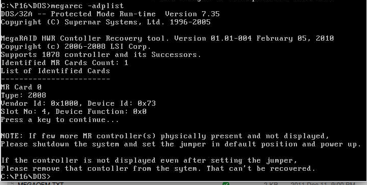

Does megarec under dos see it? Ignore lsi lots of folks have crossflashed a 9240.

Yes, megarec -adpList seems to show it:

mjws00, thank you so much. You saved my bacon. I don't know how you guys figure this stuff out, but thanks for sharing it. I can't believe all those contortions worked.
