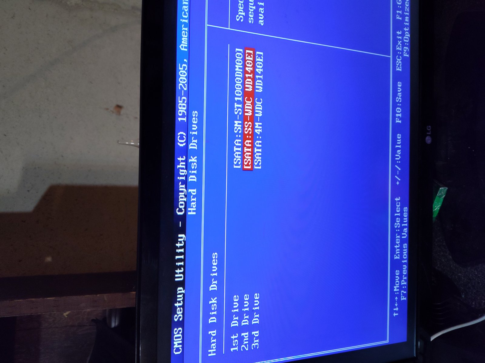

Can you see the two missing disks in the system BIOS?
artemisery
Jan 11, 2024
14
only 3 drives show up when booting and in bios. i dont know if that is because 2 of the drives are redundant of if that means two drives arent recognized. as i mentioned to another user, i have 2 vdevs made of 2 drives each.
in the web gui it says I have 23tbs free, so all of the drives are detected there.

artemisery
Jan 11, 2024
14
sorry for the sideways picture. i didnt know it was sideways, otherwise i wouldve fixed it before uploading.
NugentS
Apr 16, 2020
2,947
This is not a TrueNAS issue.
Based on your hardware spec all drives should appear in the BIOS. If they aren't you have a hardware issue of some kind

artemisery
Jan 11, 2024
14
I resolved my hardware issue, but the problem persists. turns out my pcie to sata expansion card went bad (which was why 2 drives were not detected in the bios) now all the drives are detected, but unfortunately the drives were indeed wiped.
