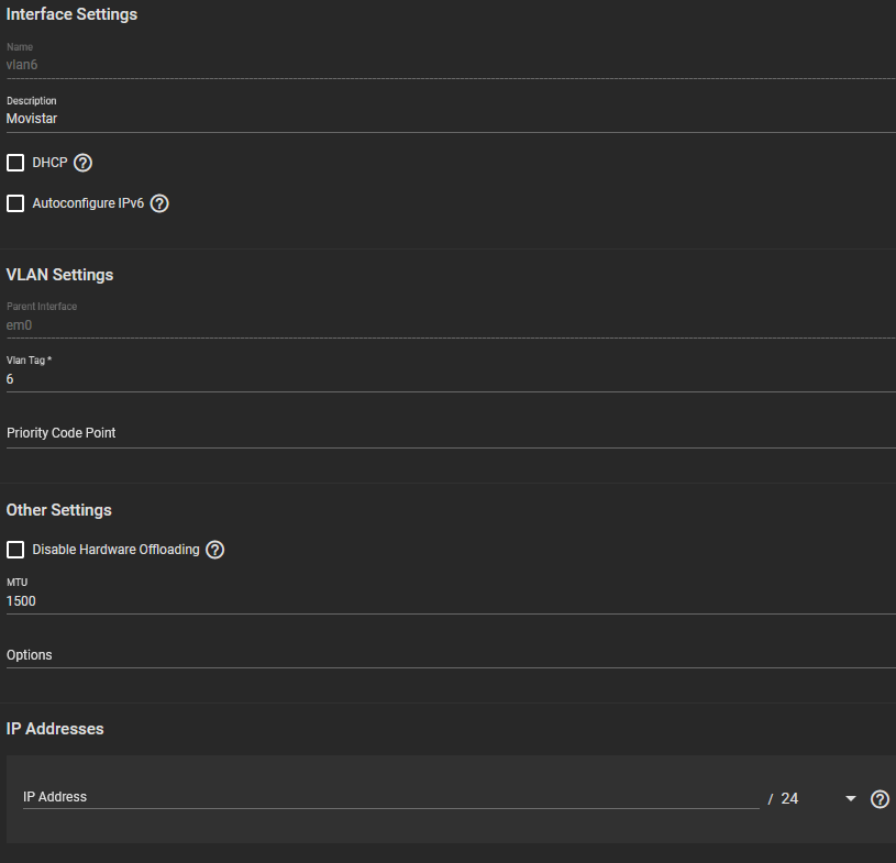

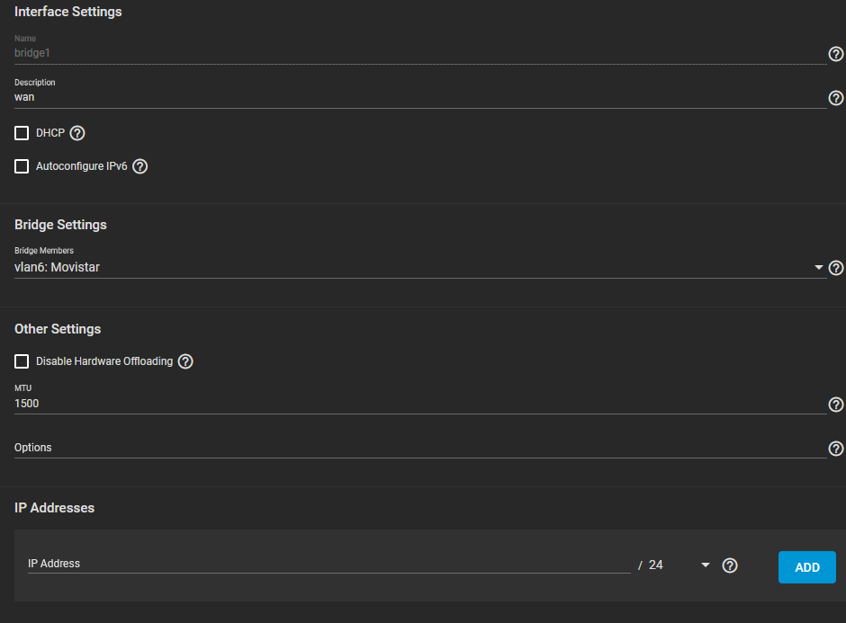

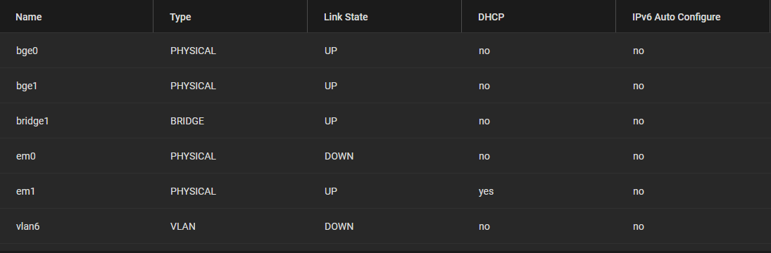

This is my network summary now, i test to connect my pfsense vm wan nic to NIC em0 directly, VLAN6, and bridge1 with and without vlan6 in pfsense config and i can not connect anyway
Bridge config
Vlan Config
9,700
In those screenshots, em0 and vlan6 are both showing as down... are they connected to something that's up?

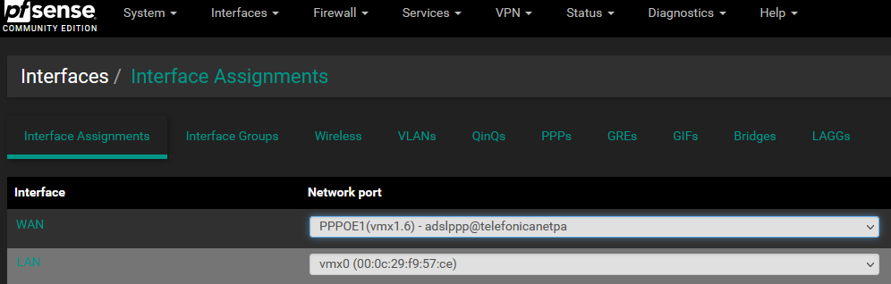

and this is my config pfsense working virtualized with switch esx with vlan 4095
