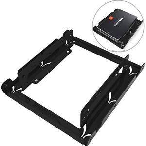

Can one combine both types of storage on a single server? I was wondering about using 2.5" to 3.5" mounting kits for this very purpose.
If so, wouldn't it make sense to create 2 pools, so as to optimise performance?
