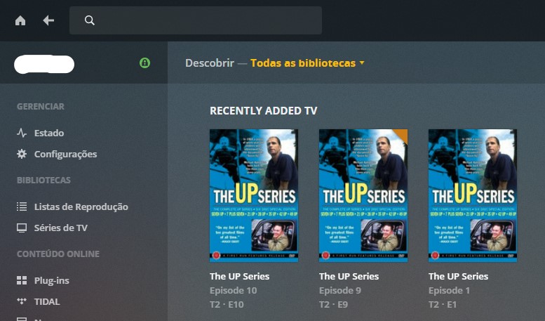

I just reinstalled the Media Server Plex.
Now it's working with another problem.
All movies have the same metadata as "The UP Series".
But the player is working with the correct movie. But when I add the external caption the movie does not work anymore.
I'm getting tired, I'm going to install an older version of Freenas, that everything worked before. Without too many complications.
