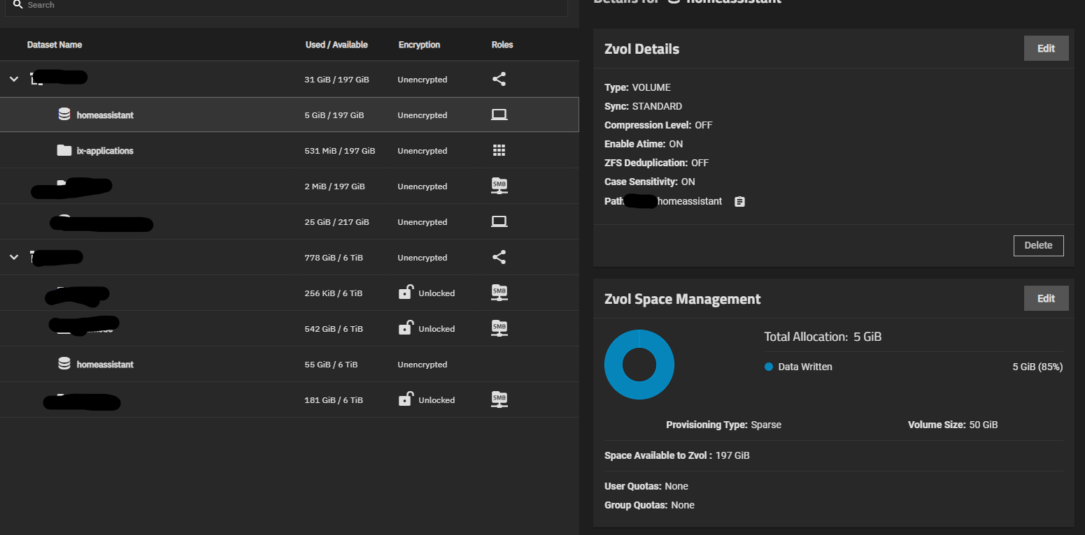

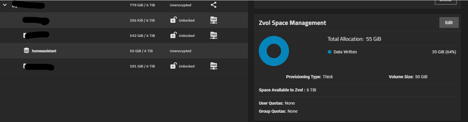

The new zvol has only 4 gb data written instead of 35 gb (also for some reason now 55 gb are allocated, I deleted the @relocate snapshot via the GUI).
Home assistant is working and recognizes the 50 gb allocation:
Can I safely delete the old zvol or is there still some dependency on it?

Provisioning type: Sparse means you won't necessarily be using all the blocks...
You'll see that the larger/original was Provisioning type: Thick (write/own all the blocks even if not used yet)
I think that mostly explains the difference.

So basically I can ignore the difference in size then and delete the original zvol? I'll create a snapshort first anyway to just be sure.
I posted the commands I used, I didn't intentionally change the provisioning type. Nothing wrong with sparse I guess?
I didn't really catch that detail, thank you! Now that you pointed it out it's blatant though.

It's highly unlikely that zfs send | recv only "partially worked"...
If it works at all, it's going to be a full and complete "copy" of what was on the original.
I would say safe to do what you want with the old one if you're running with the new one.
I also wanted to say that compression probably accounts for the other large difference... thick provisioned would be lots of blocks of all zero, so compresses well.
