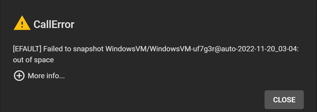

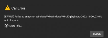

Thank you for the quick and in depth reply! I created a zvol dataset in the raidz2 pool. I then tried to create a replication task and hit a snag. I don't have a snapshot created for the zvol VM and there isn't enough room to make one.
I was thinking to temporarily add the new drives to the pool that contains the zvol vm so that I can create a snapshot to then move it? Is there an easier or better way or is that my best path?
