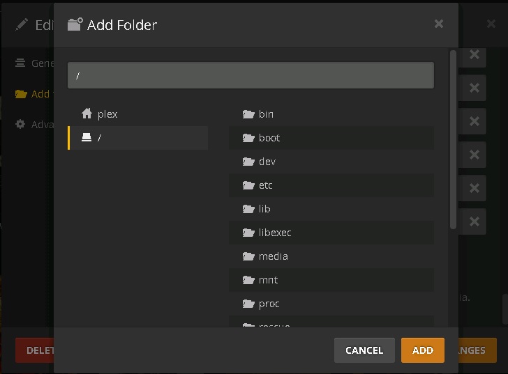

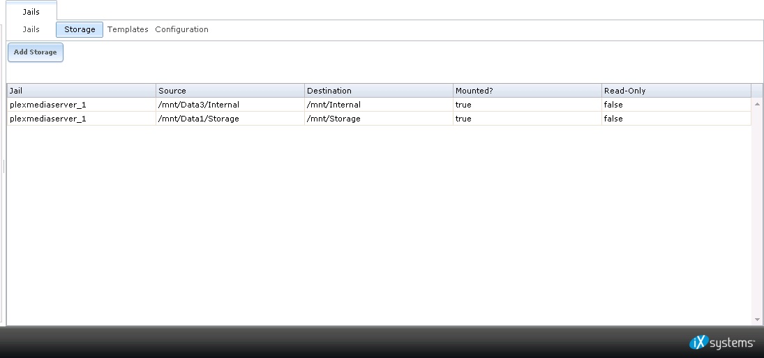

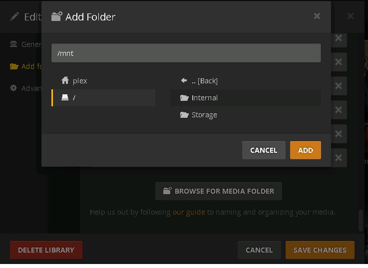

When i did it, i went under jails, storage, gave it the dataset because that's what worked for me. I attached some pictures on how mine is setup, the photo with the jails is how i configured it to have the storage of where my movies and tv shows are, the other 2 are when im connected to the webgui accessing and adding the mounts/folders

So I tried to just add the folders in PLEX and it worked. It is strange that the mount does not show in the shell but it works none the less. As long as the group ID's are the same and the group has read access I can see all the files. Maybe a bug? or does the GUI handle the mount differently?
Oct 2, 2014
925
I think it just kind of "points" to where the files are found, i tinkered with it on my own without a guide or any real knowledge and thats how i found it worked, by telling it to goto mnt/<name>
