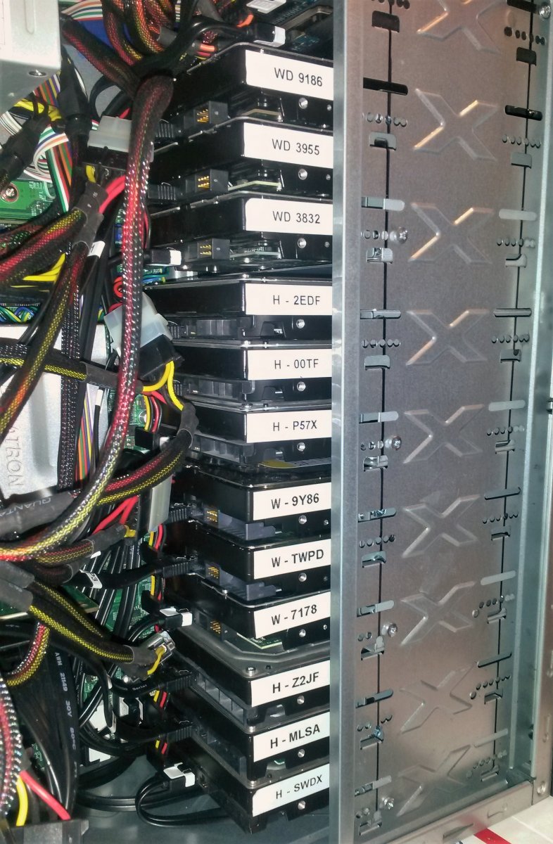

No. ZFS doesn't care what port the drive is connected to as long as the OS can find it, it will mount the volume.
You will want to label the drives so you can see the serial numbers to make it easy to find the correct drive when one fails.
Here is an example:
20160124_090832.jpg The last four digits of the SN is usually enough.
