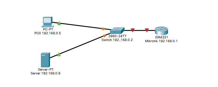

My network looks like this.
One more question.
How to restrict access to the management of FreeNas over the Internet also to the address 192.168.0.5
FreeNas has an IP address of 192.168.0.9
