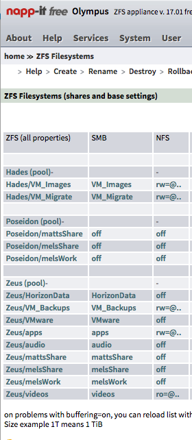

When i say Containers i mean my Pools/Filesystems. In the picture attached you can see what i'm referring to. Most all of these shares Use CIFS/SMB to connect to the data, however there are shares in there (example Zeus/apps;Zeus/VM_Backups;Hades/VM_Images;Hades/VM_Migrate) which share both CIFS/SMB and NFS capabilities...
If it's ZFS, you can import it fine. It's not ideal due to specifics with the partitioning, but it should work.
Are there still long standing issues with SMB/NFS Sharing the same Share? - in my configs its usually CIFS has Read-Only and NFS has R/W or vise versa.
If one is read-only, it should be fine.
Will the existing permissions get reset when importing and will i have to reset them?
Not if you do it carefully. Preserving UIDs/GIDs is a requirement, naturally.
