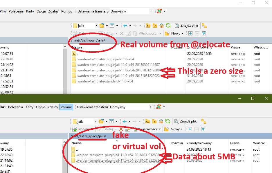

I did the migration and everything seems ok, but I have this inaccuracy and I would like to fix it.
First of all, I got rid of the physical volume "Extra_space" and did not create such a volume on any disk, and yet I have the same effect as in the photos. The "Extra_space" volume is the volume that existed before the jails relocation operation. Now he is physically gone.
I would like to somehow move these two directories from "Extra_space" to "Archiwum" so that "Extra_space" is no longer visible in the system. How i can this repair?

Those directories look to be old warden plugin directories and can likely be removed all together. Does extra space exist in /mnt ?

How can I safely remove these directories from the virtual mount point?
Jan 7, 2015
1,153
Youl likely need to destroy these defunct warden datasets. Its done in the format zfs destroy POOLNAME/dataset in a host SSH session. Locate them, its going to be somewhere in say /mnt/Extra_Space/jails or /mnt/Archiwum/jails. Doing zfs list will show you, and from there you can locate the offending datasets and destroy them, once your sure.
You need to be absolutely sure what you are doing here as this could be and is dangerous to unleash on the wrong dataset, poof gone.

root@TrueNas:~ # zfs list

Jedrek
May 25, 2017
71
This are the all my pools.
I look for this:
Archiwum/jails/.warden-template-pluginjail-11.0-x64-20181031212808 3.56M 66.1T 3.56M /mnt/Extra_space/jails/.warden-template-pluginjail-11.0-x64-20181031212808
Archiwum/jails/.warden-template-pluginjail-11.0-x64-20181031222022 3.56M 66.1T 3.56M /mnt/Extra_space/jails/.warden-template-pluginjail-11.0-x64-20181031222022
I looked through the thread but I don't know what to do next.
Jan 7, 2015
1,153
ok so plug those found datasets like so..
zfs destroy Archiwum/jails/.warden-template-pluginjail-11.0-x64-20181031212808
zfs destroy Archiwum/jails/.warden-template-pluginjail-11.0-x64-20181031222022
Jan 7, 2015
1,153
In my estimation you could probably destroy all .warden datasets, but go easy. You could probably also start purging some of the 11.x and 12.x series iocage datasets too, but one step at a time. Those will require the -r flag in the zfs destroy command. And looking a bit closer at your zfs list, you could likely just destroy the dataset Archiwum/jails dataset with the -r flag like so. Just be right careful here, and ask if not sure. Config backups, manual snapshots, etc, before you start doing things like this are always a good idea.
zfs destroy -r Archiwum/jails as all thats even in it are old defunct warden templates.

Thank you for the clarification. Yes, I am determined to clean up unnecessary warden elements, but I would like to do it safely, without any mistakes, and with the possibility of recovering them. I would also like to somehow check whether everything works as it should after deleting it. So please give me instructions, preferably step by step, on how to do it. Thank you

I destroyed resources:
My mounting point has disappeared:
Extra_space/jails
What should I do next?
I don't really know
How can I safely clear the rest of .warden?
Jan 7, 2015
1,153
I think you got it cleared out right those were the offending two you wanted gone. You can repeat the commands until zfs list no longer shows any .warden datasets.
Jedrek
May 25, 2017
71
I took a snapshot of the Archivum/jails and then deleted zfs with the -r attribute and everything was deleted without any problems. Now how can I check whether the deleted resources were not needed for something?
I no longer have any .warden resources
Jan 7, 2015
1,153
.warden stuff is dead and not needed as related to current truenas. All jails use iocage and have for some time now. Retain your backups and snapshots awhile just in case.
