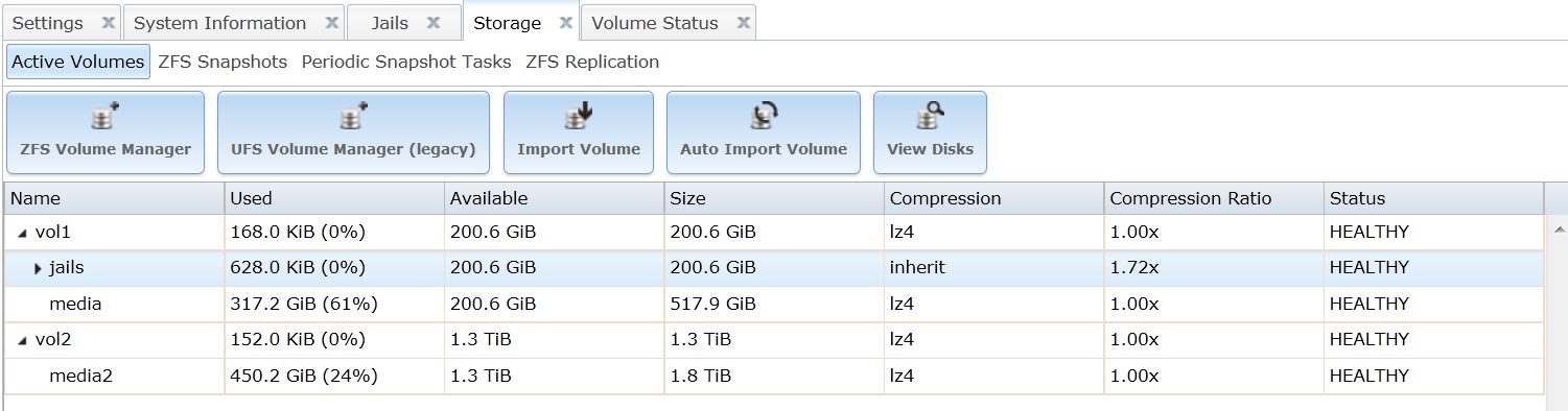

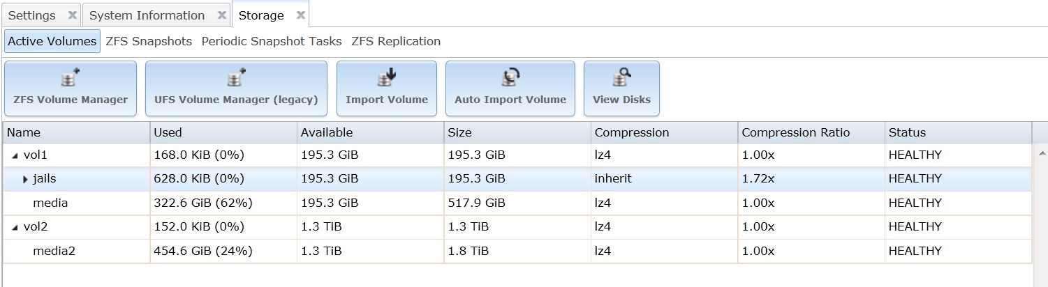

HOWEVER, now under the volume management, my first drive (vol1) is showing a total size of 517.9GB, instead of the original 950+GB. Every time I add media to the volume 2 (/mnt/vol2/media2) it lowers my "size" and thus the % Used changes.
Is there any way to separate the jail from supposing the size of the "pointed to" directory and reflecting that in the available drive space?
I've attached two photos of the FreeNAS storage tab, reflecting the changes after loading ~4GB of media into the "TV" directory. Notice how the vol2-->media goes from 450.2 gb used to 454.6 gb, reflecting the addition of media. Inversely, the available size of vol1 goes from 200.6 gb to 195.3 gb.

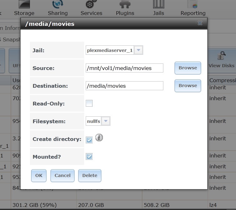

I have no problem seeing the files in Plex. Why would mounting the storage change this? I'll try.
EDIT:
After checking mount, I've noticed no difference in drive size/availability

If you don't mount the storage it doesn't know where to look for the files. What you're seeing in Plex is the metadata from the library. Not the files.
Think about it. If it's not mounted where would the files go?

its copying the data from source to destination because the actual media is not mounted. essentially it is copying the data from vol2 to vol1 because you didnt mount the storage
I've been able to access/watch all of my TV programming through plex with "MOUNT" unchecked, so I doubt its just metadata I'm seeing. Updates (new) files added are reflected in a library update through plex GUI

before MOUNTING the storage, go in to /mnt/vol1/jails/plexmediaserver_1/media
then rsync the files from /mnt/vol1/jails/plexmediaserver_1/media/tv to /mnt/vol2/media2/tv
once done, delete the files in /mnt/vol1/jails/plexmediaserver_1/media/tv
mount storage

think of it like this. You told your jail that you wanted anything located in /mnt/vol2/media2/tv to be available in the jail at /media/tv
you didn't mount the jail, so it was copying your files to that location....since you told it to. That location of that jail was in VOL1, hence the fact that VOL1 was decreasing.
mounting the storage makes the jail think it is local storage but it is physically on another pool.

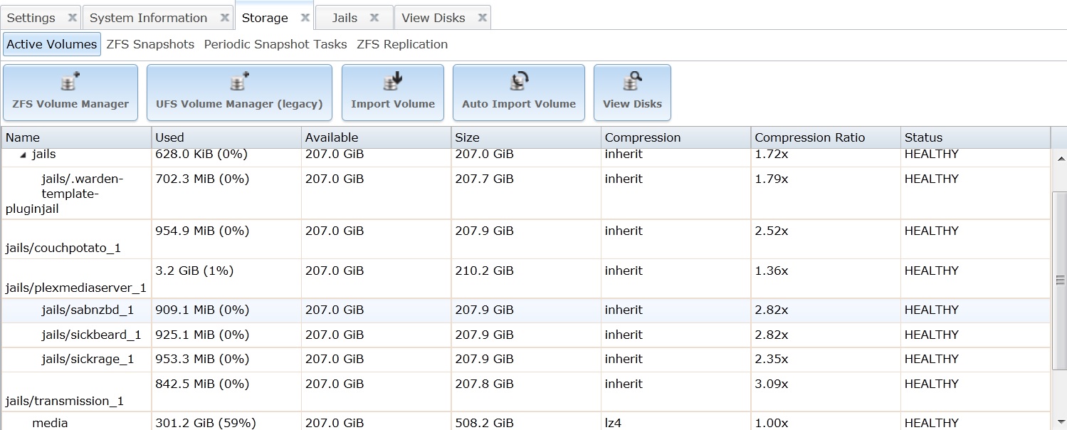

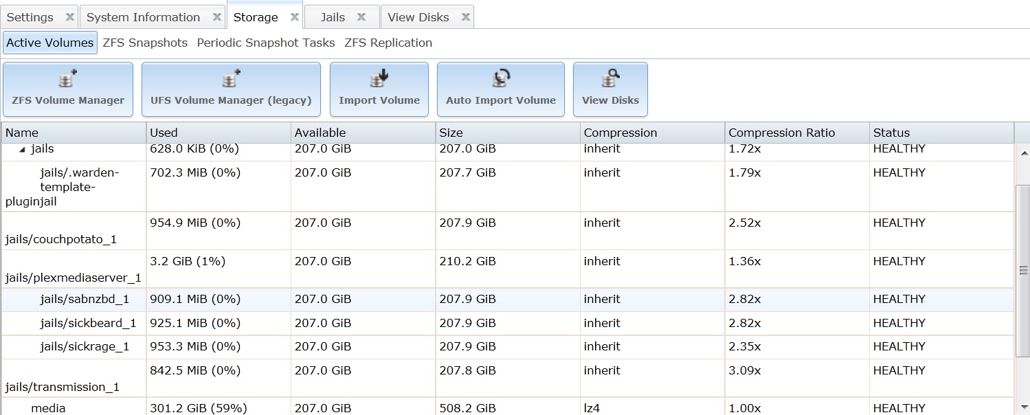

So, upon searching, I've noticed there's nothing out of the ordinary in my jail storage. I went into the jail shell, browsed to /media/TV and found there is nothing in the folder.
Notice under jails/plexmediaserver_1 the size used is 3.2GB, which isn't that out of the ordinary.
Every time I add media to vol2, I lose the same amount in overall size in vol1 (vol1/media now has a size of 508.2GB)
Still scratching my head on this.
I might need to transfer movies over to vol2 and remove my dataset and jails and start over new, see if I can recover the lost space.
Any ideas?
