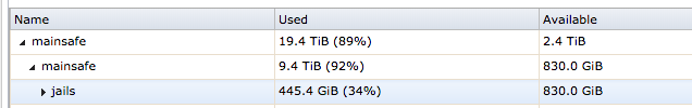

I have built new storage server that has more efficient volume configuration and I would like to migrate all data to it, including jails:
Is there any "plug and play" way I could do it? I.e. without re-configuring where jails are stored, I am looking at effectively cloning the "mainsafe" dataset to another physical set of drives.
Are there any internal IDs I would need to transfer over to make sure that the newly created FreeNAS install just recognises the cloned volume?
