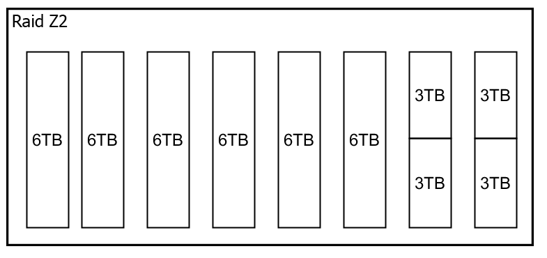

currently I have only a bunch of hard drives to organize my files. It is a mess to use and backup all of them so I decided to build a FreeNAS server. This server should consist of at least 10 drives used in a Raid z2. The following image illustrates the desired archtitecture:
The 6tb drives are from the WD Red series and the 3 tb drives are from the Seagate Barracuda series.
