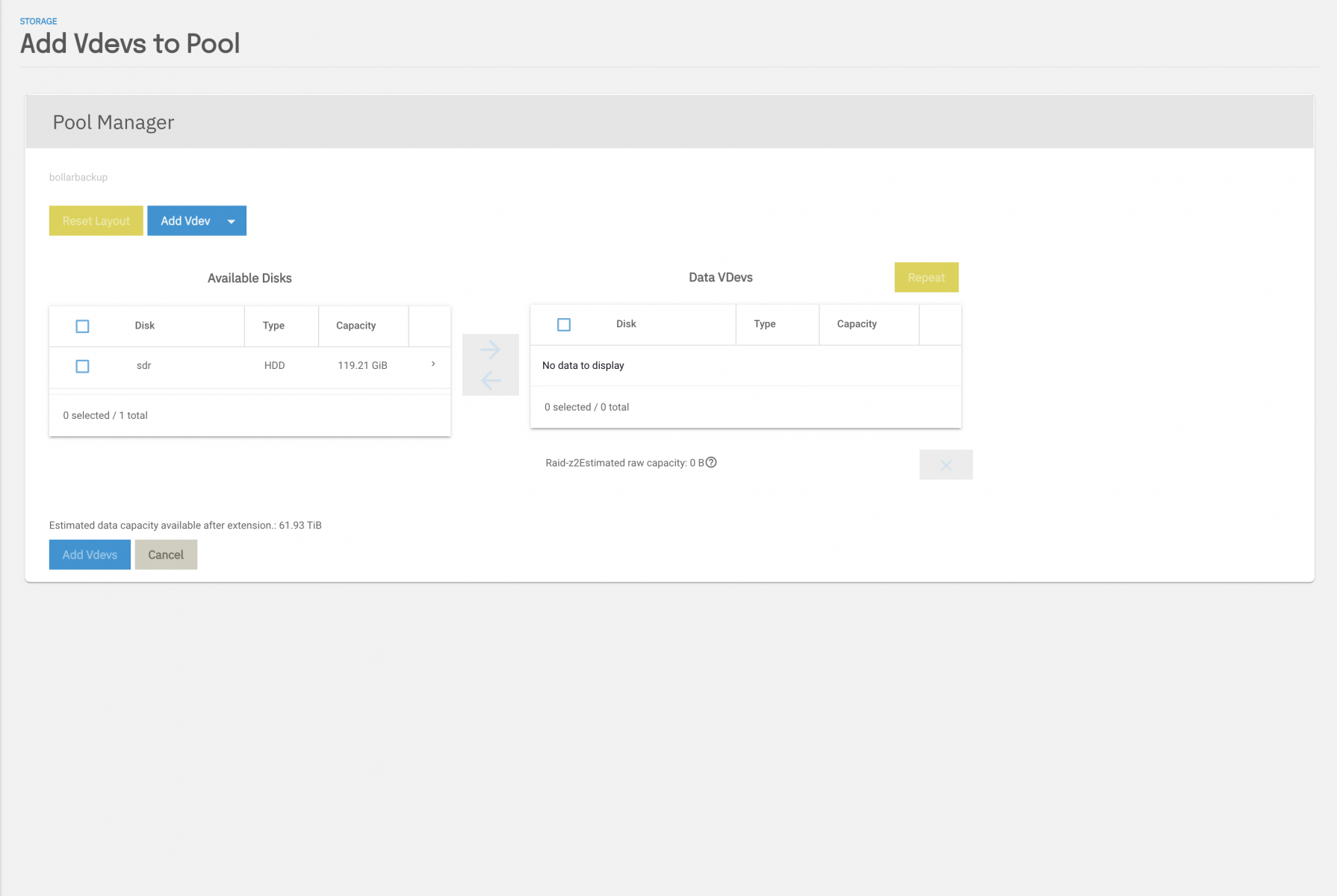

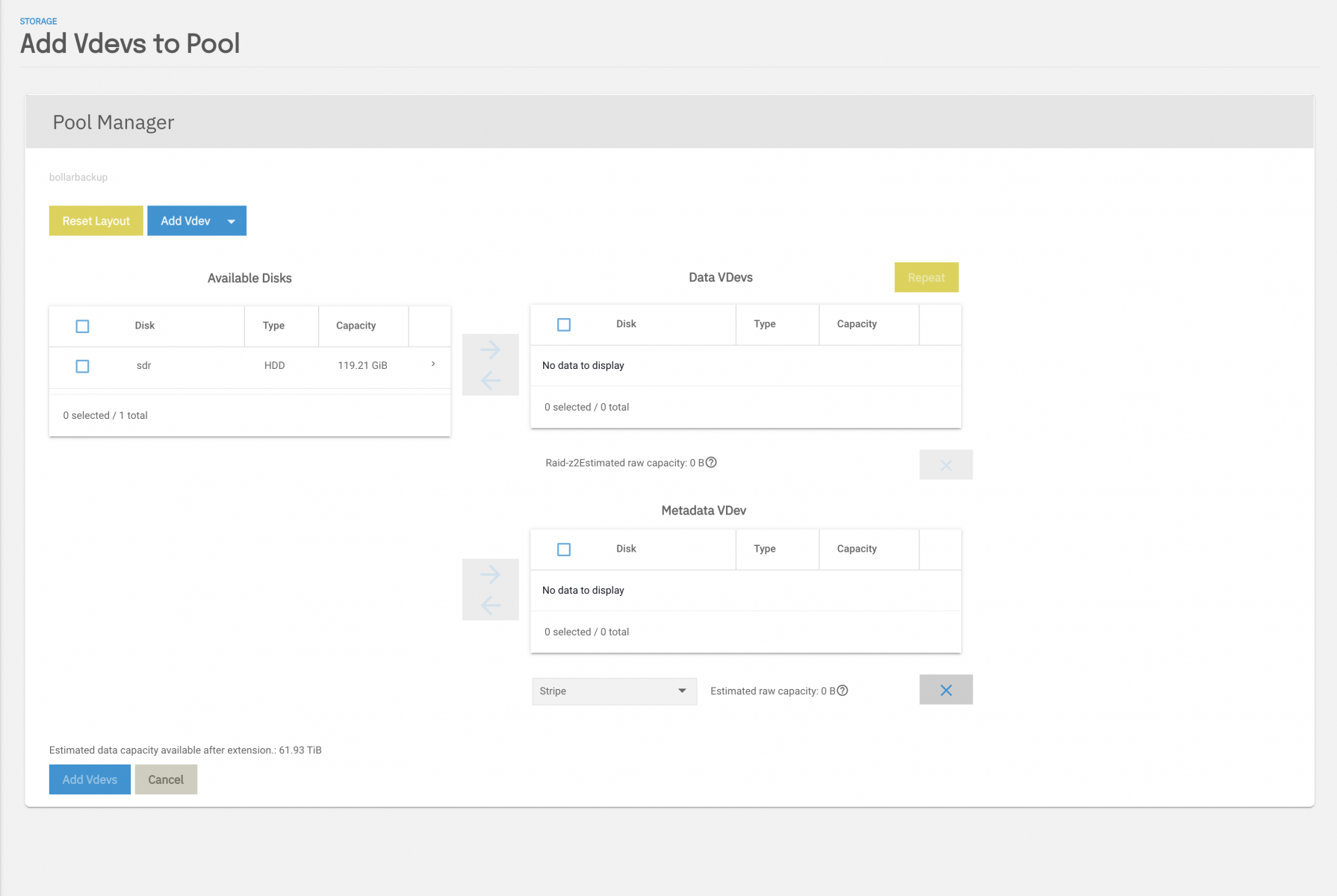

This winds up being a combination of user error and confusing interface. When you select to create a metadata VDev, the Metadata VDev drive selection panel is added below the Data VDev selection panel.
Now that I understand what's going on, I was able to add a three-way-mirror via the GUI.
I'll write an enhancement request for this in Jira.
