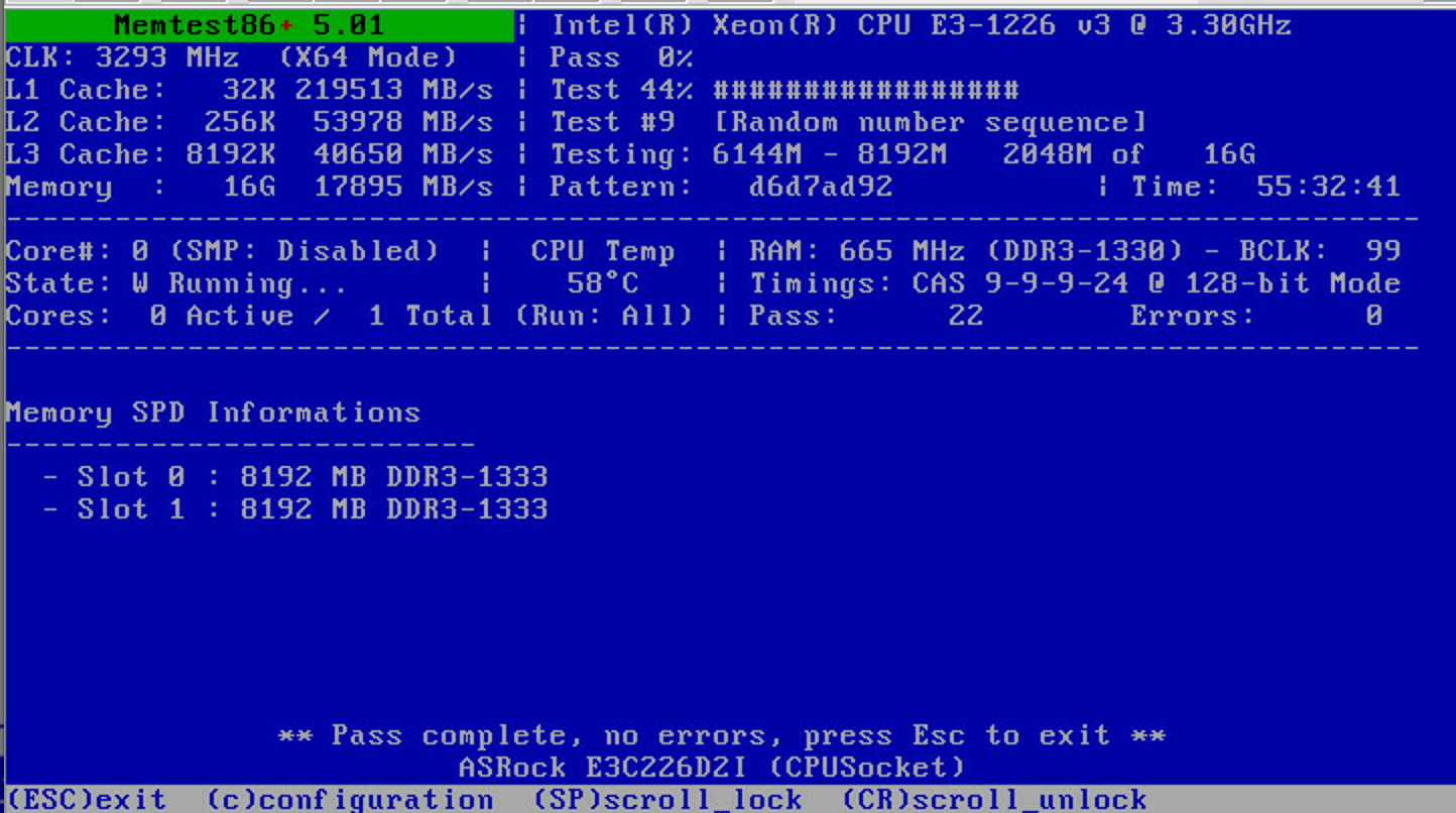

I turned on my system for the first time today and it didn't blow up, so that was great - but I have two questions:
  1. My mobo is ASRock E3C226D2I and I am using ECC RAM. Do I need to enable ECC RAM in the BIOS/UEFI somewhere? I couldn't find any options regarding enabling ECC.
  2. I am currently running Memtest86+ version 5.01. I searched online and saw that Memtest86+ does perform ECC tests to ensure ECC is functioning properly. Do I need to do anything special in Memtest86+ in order to test for ECC functionality or will it automatically perform ECC checks if the the memory stick is ECC and the mobo is enabled for ECC (if it needs enabling)?

Not sure if this answers your question, but it may be something you'd like to keep in mind: Memtest86+ v. 5.01 did not catch ECC errors (or find any other errors) for one of my DIMMs on my Supermicro X10SL7; the ECC errors only showed up in the event log in the BIOS. See also my posts in the X10SL7 thread. I also swapped DIMMs and ran Memtest again just to be certain that it wasn't the board (didn't mention this in the X10SL7 thread yet).

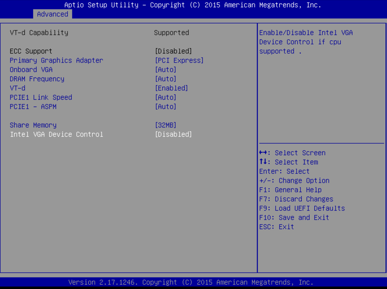

I did find out where in my BIOS the ECC enable option is. It is in the North Bridge Configuration section. It was enabled when I went in there - so I'm assuming that's the default or it recognized my RAM as ECC and enabled it.

I've run Memtest (with the default settings) for over 80 hours (on separate occasions) and it didn't find a single error (I have screen shots of all of the Memtest runs and the event logs in the BIOS if you'd like to see them -- printed them to satisfy my own paranoia. The was that a 0 or an 8 question always seems to haunt me later). However, the event log in the BIOS (which I posted on page 15 in the "SuperMicro X10SL7-F" thread in "text form", not an image) does show ECC errors. I'm not very knowledgeable about memtest, so I may be doing something wrong -- I just put the disk in the drive and run it.

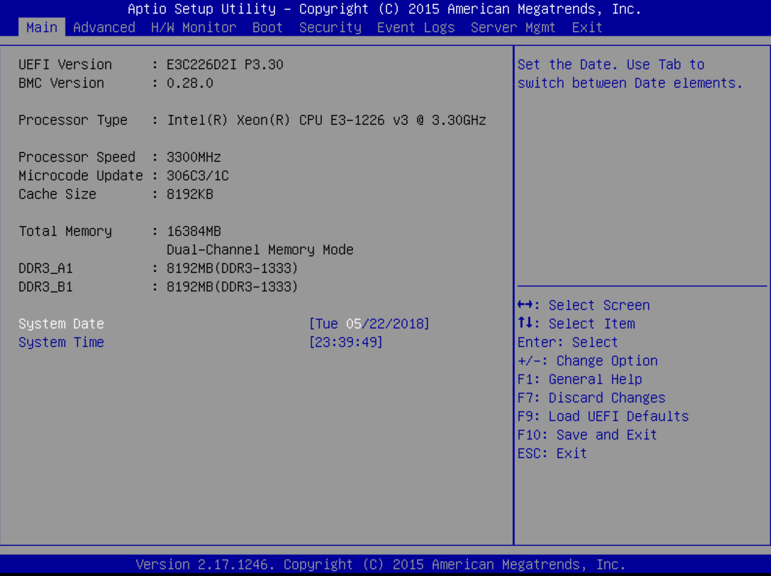

I know I am resurrecting a very old thread, however this is the one I could find on the subject of ASRock Rack E3C226D2I + ECC RAM.
I purchased 2x of Hynix DDR3 UDIMM that are supposed to be ECC however I see "ECC Support" greyed out "Disabled". Does this mean the board does not recognise the RAM as ECC?
Running the latest BIOS, CPU supports ECC.

Your hynix RAM should be clearly labelled. If it's ECC then it should be marked PC3-10600E-X-X-X or PC3L-10600E-X-X-X for DDR3-1333. You can always check the long hynix ref number.

Thanks. I simply could not believe a reputable business seller on eBay can so blatantly mis-advertise memory as "Server ECC" (in multiple places all over their listing) when it is clearly neither! I found it on a Taiwanese website and it's a normal Desktop UDIMM. What a waste of time (and electricity I have already spent on memtest'ing it)...
