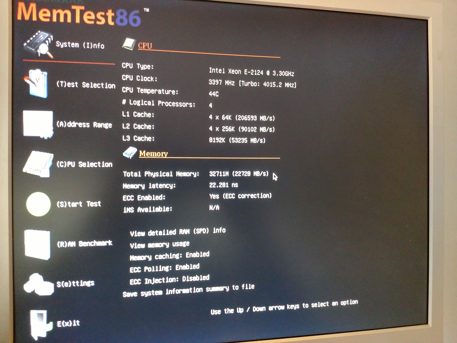

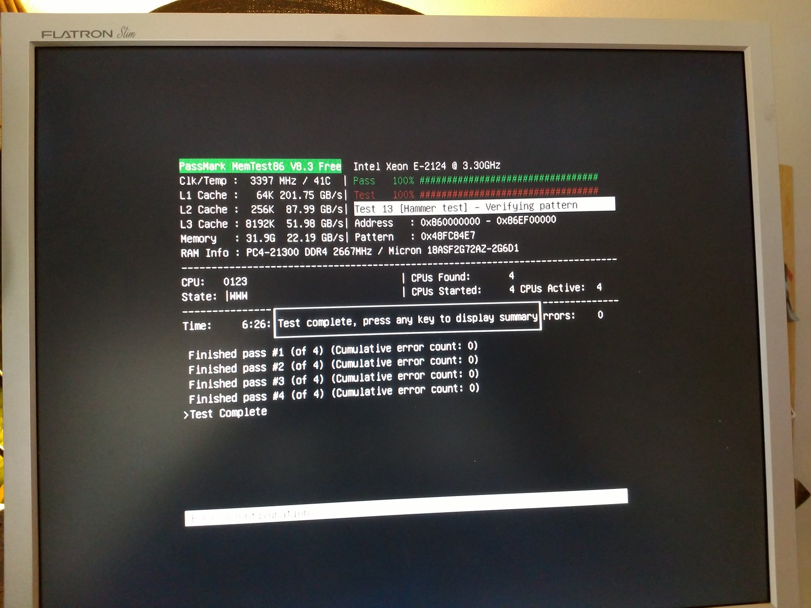

This is the end of memtest86 v8.3

This is the memtest86 v8.3 main menu
