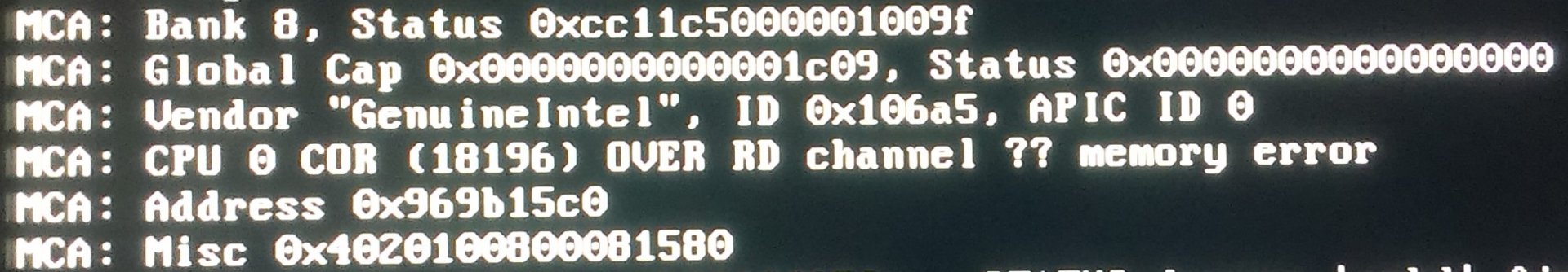

I have a FreeNAS-9.2.1.9-RELEASE-x64 built on this hardware:
X8DTL-i SuperMicro baseboard (dual cpu triple channel ram baseboard)
1x Intel E5520 CPU
3 x 2GB DDR3 @ 1333MHz SuperTalent ECC Registered
2 x WD Red (one of 4TB and one of 3TB assembled in a non-raid setup using all the space into one volume)
The case is a normal full height tower with a few fans added to it.
The platform is a 5+ years old server re-purposed as a FreeNas machine. I am in the process of backing up the NAS as a first step before updating to FreeNas 9.3 which is probably stressing the hardware quite a lot.
I have just seen in the prompt an alarming error. I have attached a print screen.
Does this mean that the RAM is starting to through errors? Should I be worried?
Thanks!

I had this very issue, it was RAM related, and after 5 or 6 passes of memtest it finally showed up, i just removed the problematic DIMM and never looked back, nor saw the same error. Youll want to SSH into FreeNAS though and type/paste "dmidecode --type 17" then scroll to see what DIMM is in BANK8 as bank 8 doenst always correspond to DIMM slot 8....

Thank you for your feedback. I only have 3 dimms installed (the baseboard only has 3 dimm slots per cpu and I have only one cpu installed). I ran the command you gave me but I am unable to spot which dimm is related to bank #8:

Try running just "dmidecode" and see if that comes up with more info

As you know, the output of dmidecode is quite extensive but I believe this suggests that DIMM1 is faulty:

Reply, worth a shot. However i have a similar make and model board, but mine does show the bank info...so thats why im a little confused.

AndyB78
Jul 29, 2015
11
Well the thing is that I have not encountered that error since then. Maybe it overheated (due to me leaving the case open which may have adversely affected the air currents). I'll keep it under attention.
Anyway, thank you for your feedback.
Kind regards!
