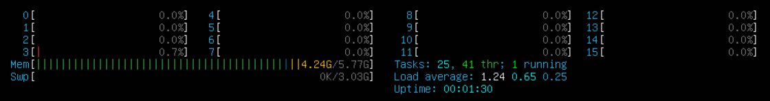

I just tried setting up a new vm and fresh installing ubuntu server with max and min memory sizes set in truenas. Didn't change the result though, ubuntu still thinks it's already using all the extra memory that could have been allocated to it, as in the screenshot above.

Can you post the output from htop?
I assume this is what you're looking for, from the vm I created fresh with min memory set:
