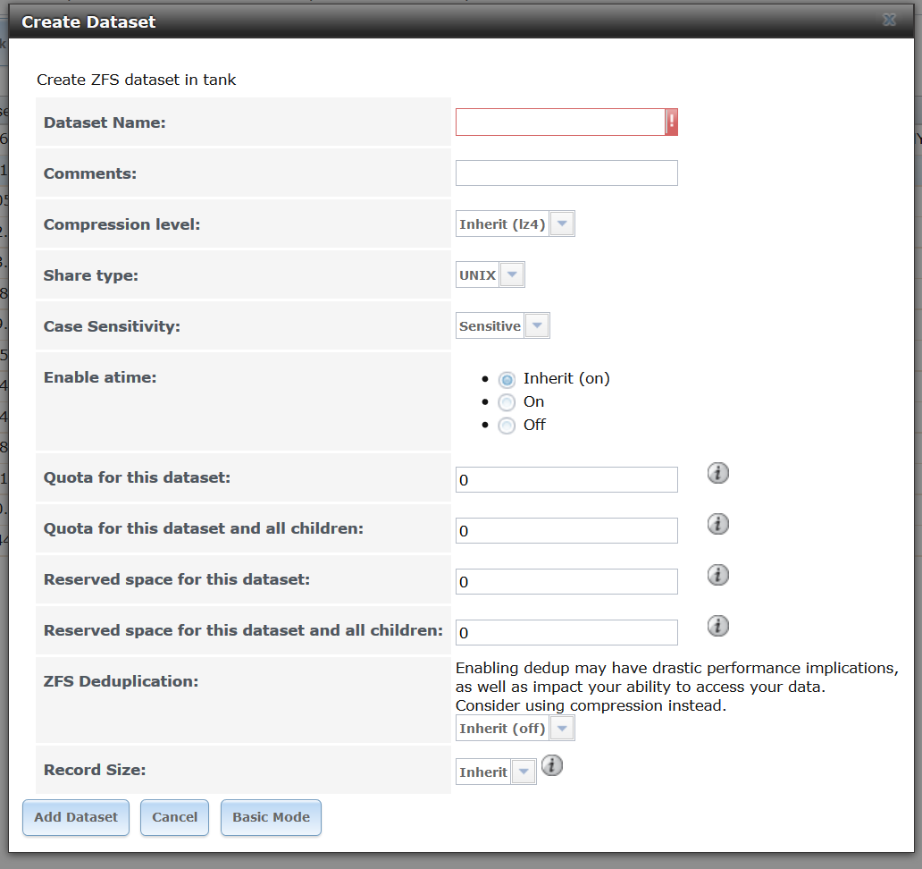

You create the datasets on the host system. It's all right there under advanced.

I can see that i can create the dataset from the screnshot you provided but how do I set the recordsize?

How do I create the dataset to be zroot/jails/MariaDB/var/db/mysql-innodb?
I cannot see an option to specify the path.
When I type the following in the Dataset Name:var/db/mysql-innodb I get this message:
Dataset names must begin with an alphanumeric character and may only contain "-", "_", ":", " " and ".".

For the host system, it shouldn't matter where the dataset is. It's when you add storage to the jail you specify the mount point.
