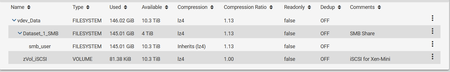

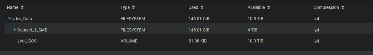

Sorry if this question has come up before. All of the forum results I could find seemed to be for different issues. This one is likely simple and I know I've done it correctly in the past but can't figure it out for the life of me this time around.
The NAS has ~10TiB available all allocated to one vDev. The SMB share in question is a 4 TiB dataset allocated from those 10 TiB. What I'm expecting is for the mapped network drive to show up reporting x TiB free of 4 TiB (the SMB dataset) instead of reporting free space out of the full 10 TiB of the vDev. I know that this can and does work as expected as my other TrueNAS server I set up years ago reports out the correct used and allocated space for the SMB dataset. But I can't find what's configured differently between the two.
What super obvious thing have I missed here? Thanks!

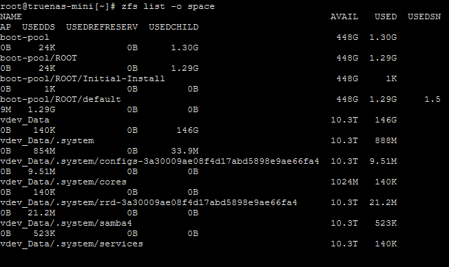

What's the output of zfs list -o space?

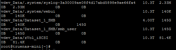

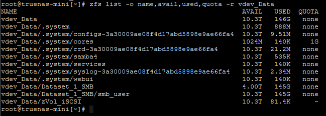

I'm seeing a disconnect here between the 4 TiB reported for the SMB Dataset vs the 10 TiB reported for the smb_user which is used to map the SMB share. (That iSCSI share is technically a 2 TiB allocation but I'm pretty sure that it's reporting that way because it's a zVol.)

In the meantime, what's the output of zfs list -o name,avail,used,quota -r vdev_Data? I should also point out that it's silly to name a pool "something vdev", it's like naming a car "something tire".

Here's the output:
You're definitely right! It's a habit I got into when I was just getting started in ZFS and I found it helpful for keeping track of which 'layer' of the ZFS filesystem I was working in. Now, it's just habit.

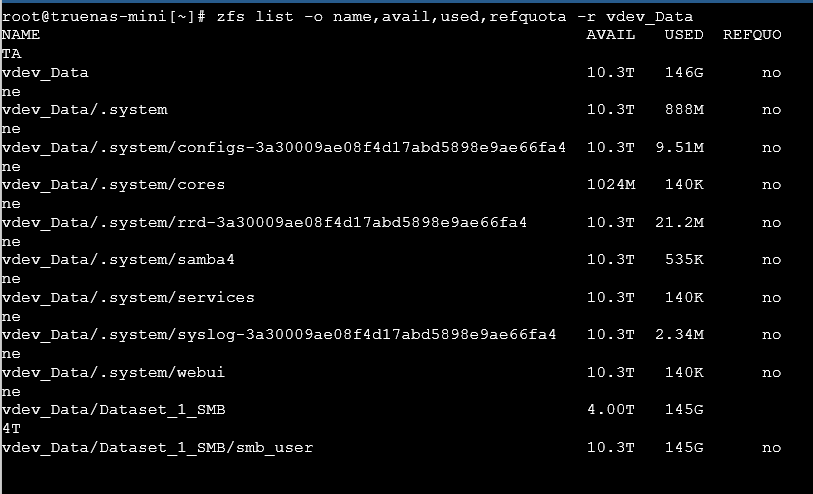

OK, let's see refquota instead of quota. At this point it better be 4 TB... once you've confirmed it, you can change it with zfs set refquota=none or whatever value works for you. If you want it to apply to descendent datasets, remove the refquota and set a normal quota.

It looks like the refquota for the SMB Dataset is 4 TiB (which is what I wanted and expected).
Is the issue that vDev_Data/Dataset_1_SMB/smb_user is showing an Available space of 10 TiB and no refquota? That's the service user that has access to the SMB share for connecting devices.
Well, smb_user as unaffected by the parent's refquota, so you can write into it up to the real capacity, so Samba presents that as the capacity, I guess.

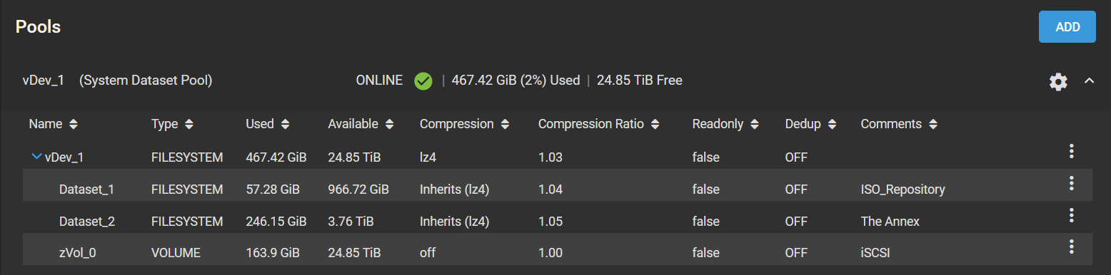

I think I've finally found the issue by comparing to my older TrueNAS installation. It has a similar setup. However, on that installation, the smb_user account did not create a child directory under the SMB dataset. (I hadn't previously noticed the dropdown.) On this installation, this account wound up with a child dataset. And, that is clearly showing the 10 TiB available space.
Where would the smb_user child dataset have come from? Is it there because I set up an ACL for the SMB share?
Dataset_2 is the SMB dataset
