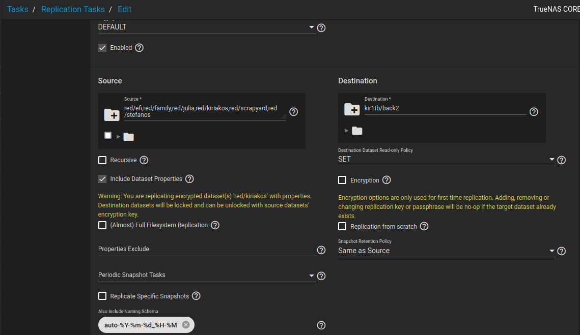

Today I had this on my hands.
Unfortunately I don't remember what I did and I'm not sure where to look.

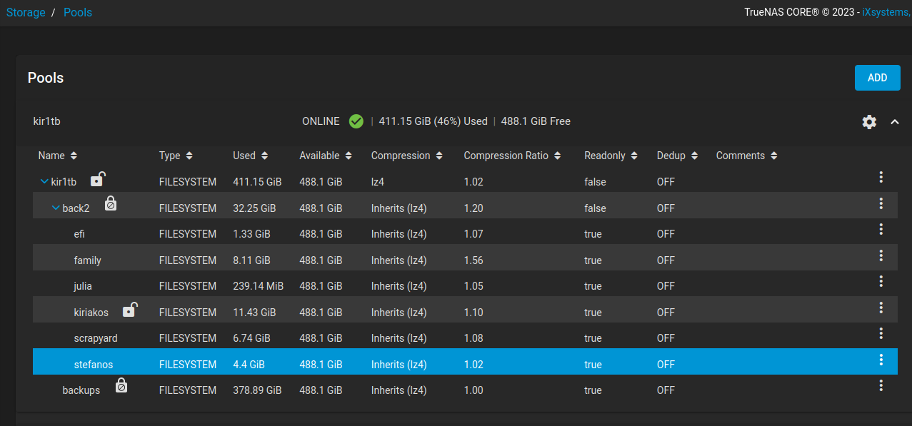

kir1tb is the name of the external HDD pool.
If I remember well, it was an encrypted pool (with the new encryption, not GELI) and inside this there are two unencrypted datasets.
On the first one named "back2" the snapshots are replicated, one of them named "kiriakos" is an encrypted dataset on the server.
When I import the kir1tb pool, I have to provide two passphrases, one for the pool (?) and the other for the encrypted dataset kiriakos.
Screenshot from 2023-09-25 18-15-43.png Screenshot from 2023-09-25 18-14-43.png
I don't know if this helps you, If anyone knows tell me where to look for what.
If I click the 3 dots on the right of the first image, only in the 'kir1tb" and "kiriakos" there "encryption actions" in the menu.
I don;t know what the icons like locks by the "back2" and "backups" datasets mean.
