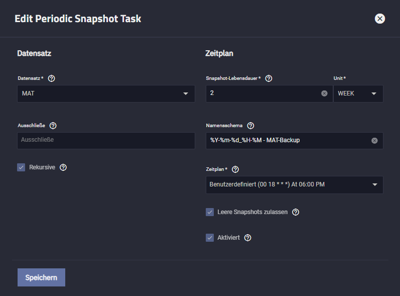

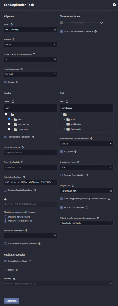

Hello everyone, I need help in creating a 1 to 1 perfect local replication including snapshots and encryption.
Previously on SCALE 22.02 I could run a replication task that replicated everything from Pool 1 to Pool 2 (no encryption on both pools) but since the update I just can't do it anymore.
Do you know how I can create such replication? My use case is to backup daily changes, so I cannot use mirroring inside the pool, since it would do unnecessary wear on the backup drives.
I used the opportunity to encrypt my pools, but this is the error message that I'm getting:
This is the error message if the "MAT.Backup" pool is not encrypted:
I'd be very glad for your help.

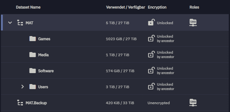

Replication "MAT - Backup" failed: Destination dataset 'MAT.Backup' already exists and is its own encryption root. This configuration is not supported yet. If you want to replicate into an encrypted dataset, please, encrypt its parent dataset.
[2022/12/19 18:39:07] ERROR [replication_task__task_1] [``zettarepl.replication.run``]
For task 'task_1' non-recoverable replication error
ReplicationError("Encryption requested for destination dataset 'MAT.Backup', but it already exists and is not encrypted.")I'd be very glad for your help.
