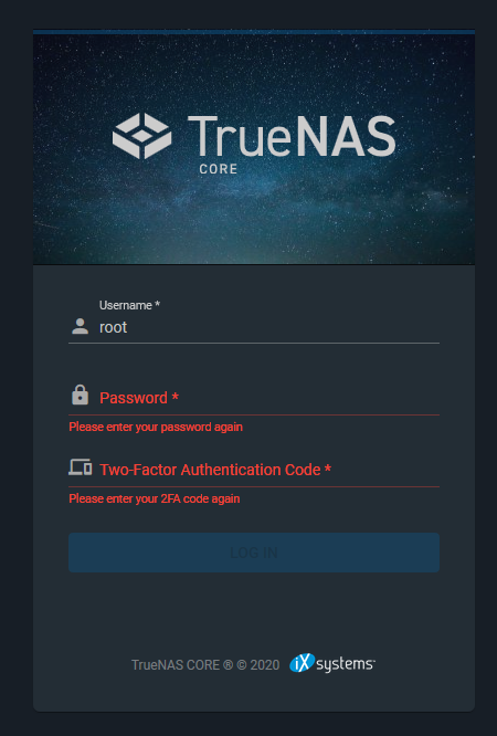

Hi All
A few moments, I went through the set up of 2FA via Systems on my TrueNAS Core 12 server.
The following are the rough guideline of steps taken:
1. Left everything as it is
2. Clicked on Enable 2FA
3. Clicked on Show QR Code
At this moment, I used Google Authenticator app from my mobile to scan the QR Code.
Mobile was set up with generating the codes and then I clicked on Save.
I logged out as I thought, there was nothing else to do and now when I try to login, I keep get the following:
I'm now unable to login.
Can anyone advise and help, I'm thinking I missed a step but nore sure?
Thanks

Hye,
Facing same issue lost my codes and keys & cant recover. Now cant login to interface
9,700
There's a thread kicking around somewhere with the middleware client call you can use from the console shell to disable/reset it...
There it is:
