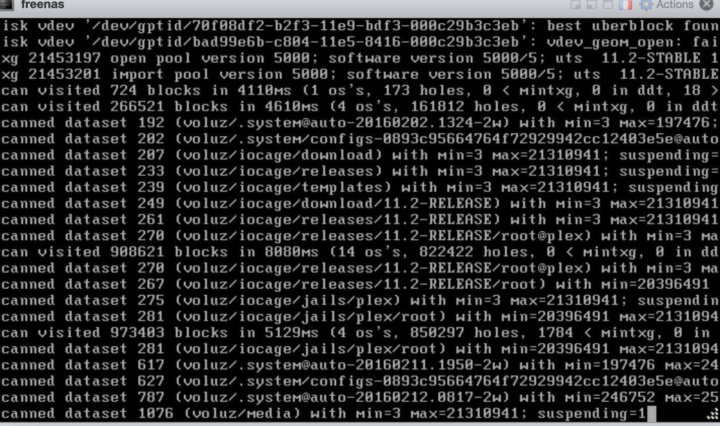

I have an 'error message' when I boot, see attached; not sure if it is a real one or not? See the vdev_geom_open message (it seems truncated but I am not sure where the full message is expected to be stored?)
