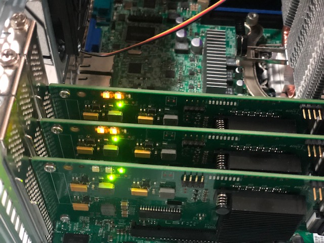

When I built it, I only had 2 of the LSI cards (third one was still in the mail), so I booted it up and noticed there was no CTRL C option for controller settings. I noticed both amber lights of the HBA were lit.
I found out that if I cut the power to the power supply while it's running, then turn it on again, I have a 70% success rate on it booting correctly and shutting down the amber lights and flashing only the heartbeat green led.
After adding the third card (and thus flashing all three at the same time to v20 IT), I noticed the third card would always start up correctly, I attached a picture to clarify.

Yep, first slot always run fine no matter which card is on it.
I`ve got the server running since jan, when I have to shutdown/power on I found a workaround: power it on, it will try to power on - shut off - and go on again. When it goes on again, turn the power supply off on the switch after 5-10s. Then, turn everything back on and it will work. I don't know why this is, but it works..
I'm considering buying another motherboard
