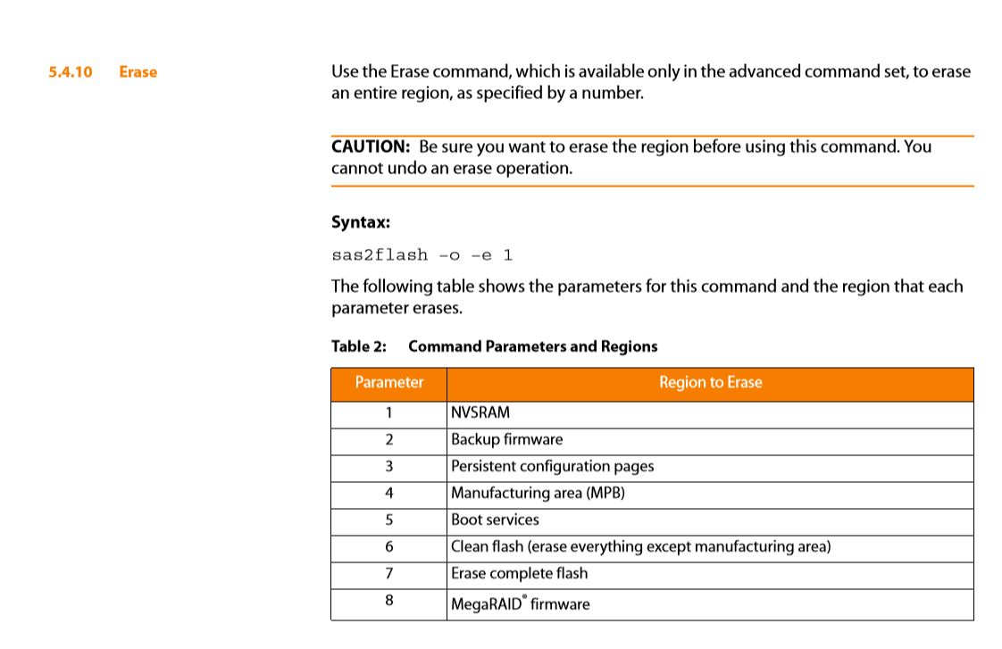

Problem solved! Warning, use this information at your own risk!
At the Broadcom website, I found the download of Package_P20_Firmware_BIOS_for_MSDOS_Windows
This is the listed firmware/bios for 20.00.07.00 version. Within the zip file is a pdf file called,
SAS2Flash_ReferenceGuide.pdf AND within that file is found the means to erase just the bios section of the
flash chip. Here's a screen shot below.
Here are the steps I followed to erase JUST THE BIOS ftom my HBA so it would take much less time to boot up. Please note: the steps below were completed through the IPMI remote console of the server containing the HBA involved.
  1. Shut down your FreeNAS machine and unplug the power cord.
  2. Open your case or chassis and remove the SAS cable from your HBA card.
  3. Plug the power back in and boot your server entering the BIOS utility screen
  4. Go to the boot section and set the first boot to the UEFI shell and restart.
  5. From the SHELL> prompt, type in this command sas2flash -list save the results of this output by your preferred method.
  6. From the SHELL> prompt, type in this command sas2flash -o -e 5 to erase the boot services area of the flash chip.
  7. And one last time, type in sas2flash -list and verify the Bios Version now reads N/A
  8. Type exit @ the SHELL> prompt and power down your server, plug the SAS cable back into the
HBA and return your machine to normal operation. Your machine should now boot much faster.:D
Please let me know if changes can make the process more clear and concise. Dave
