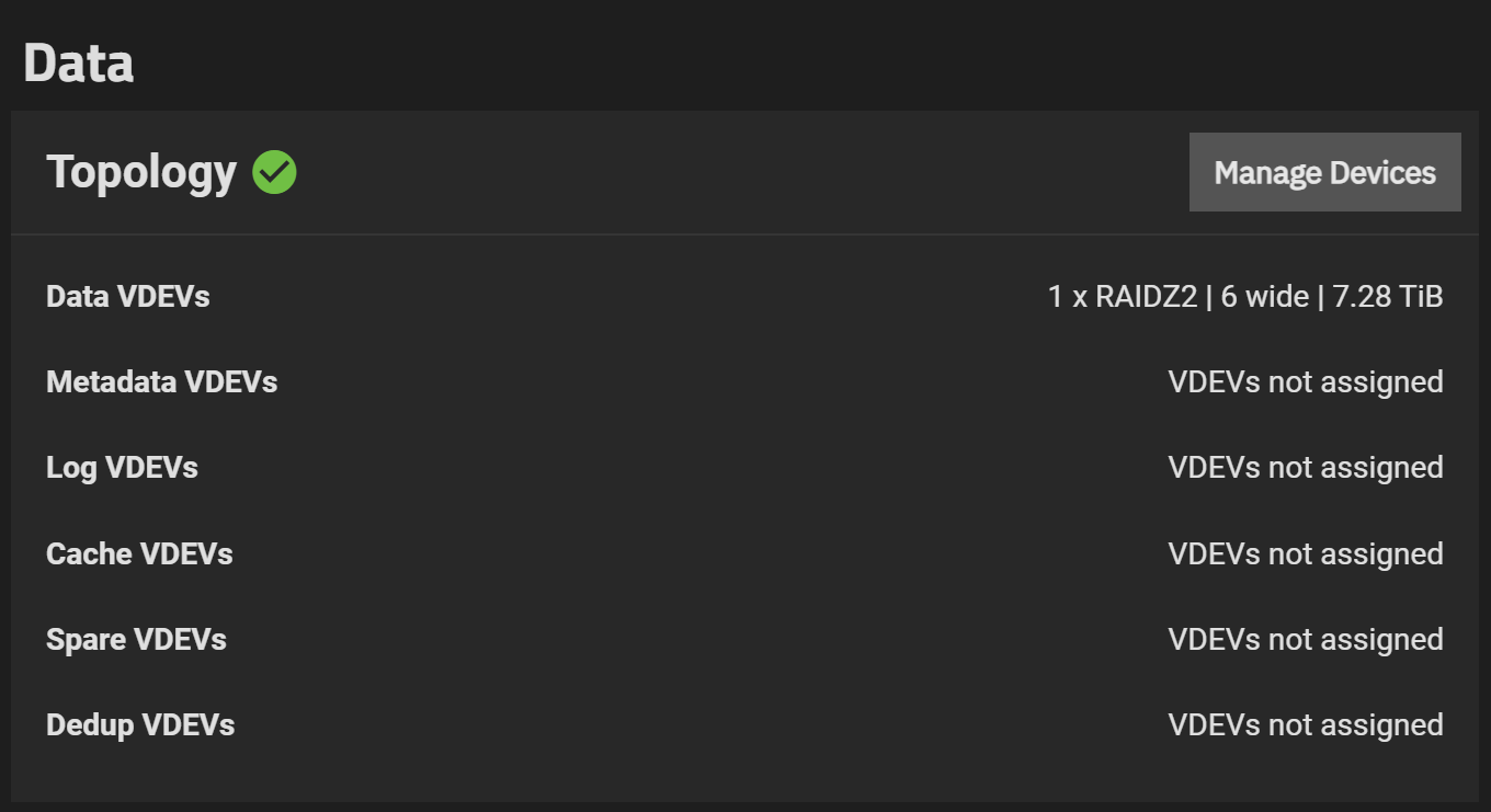

Can you please describe your hardware in detail, specifically around your storage controller type, hard drive model, drive count, and the layout? The Storage Dashboard in TrueNAS SCALE should indicate most of the latter, eg:

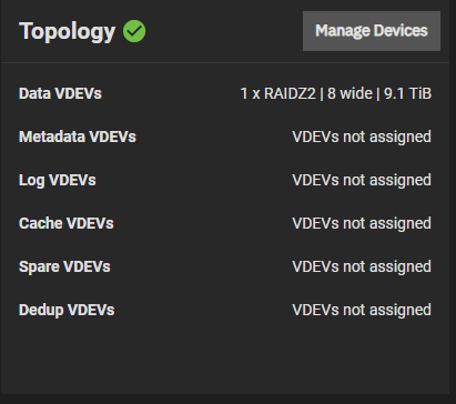

Hi, @HoneyBadger. thank you for the reply.
My TrueNAS is on an Inspur NF5280M3 server. The controller is from chipset (The hard disk is connected to the SATA connector on the motherboard). All 6 drives are WD HC320 8TB.

Your server appears to not use any RAID logic on the integrated controller, which is good - and your drives are not SMR (shingled) so the throughput numbers will not be hampered by that.
The pool layout of 8 wide Z2 means that you will get the effective "write bandwidth" of four drives, but I would think that you should be able to get more than 100-200MB/s from six HDDs.

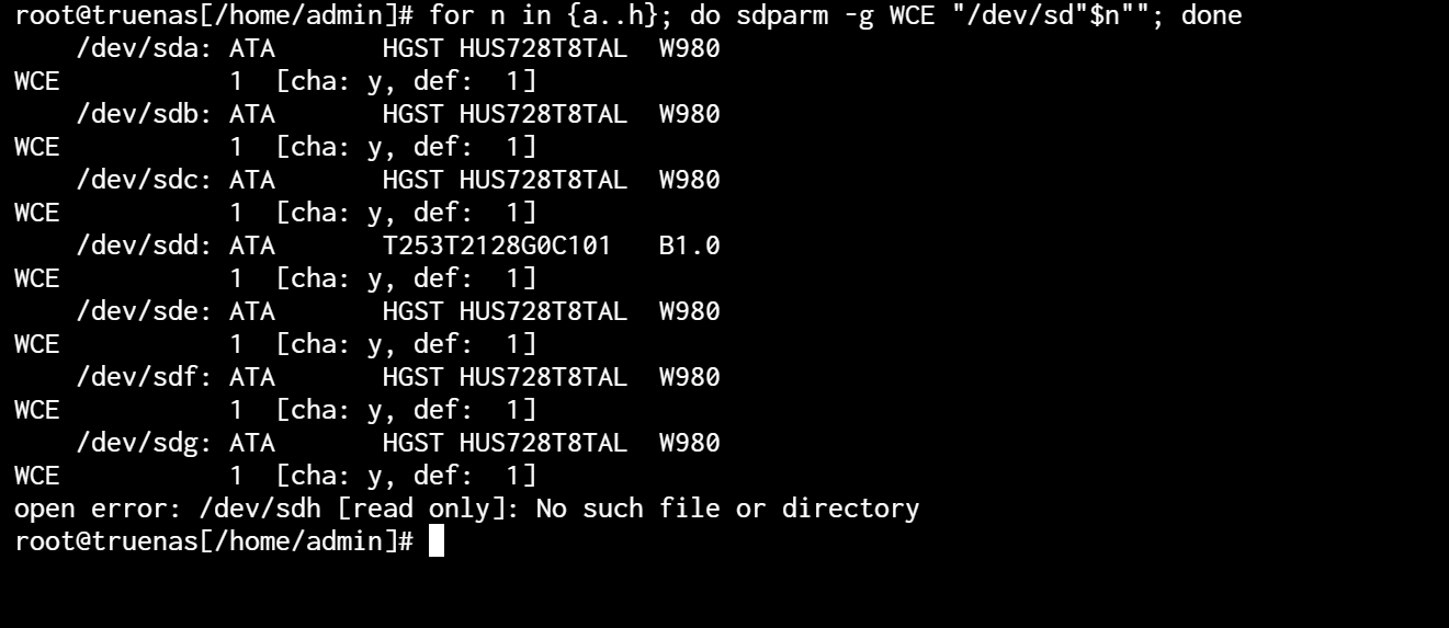

Can you please run the following command against your HDDs to ensure that the disk write caching is enabled:
for n in {a..h}; do sdparm -g WCE "/dev/sd"$n""; done
This will query drives sda through sdh and ask for the "Write Cache Enabled" value.

Thank you, here are the results, I think caching is enabled.
Regarding sync, I haven't changed it, so it's "standard".

That does show WCE:1 (Write Caching Enabled is TRUE) so that part should be sorted. We might need to dig into some fio benchmarks to check write performance.
