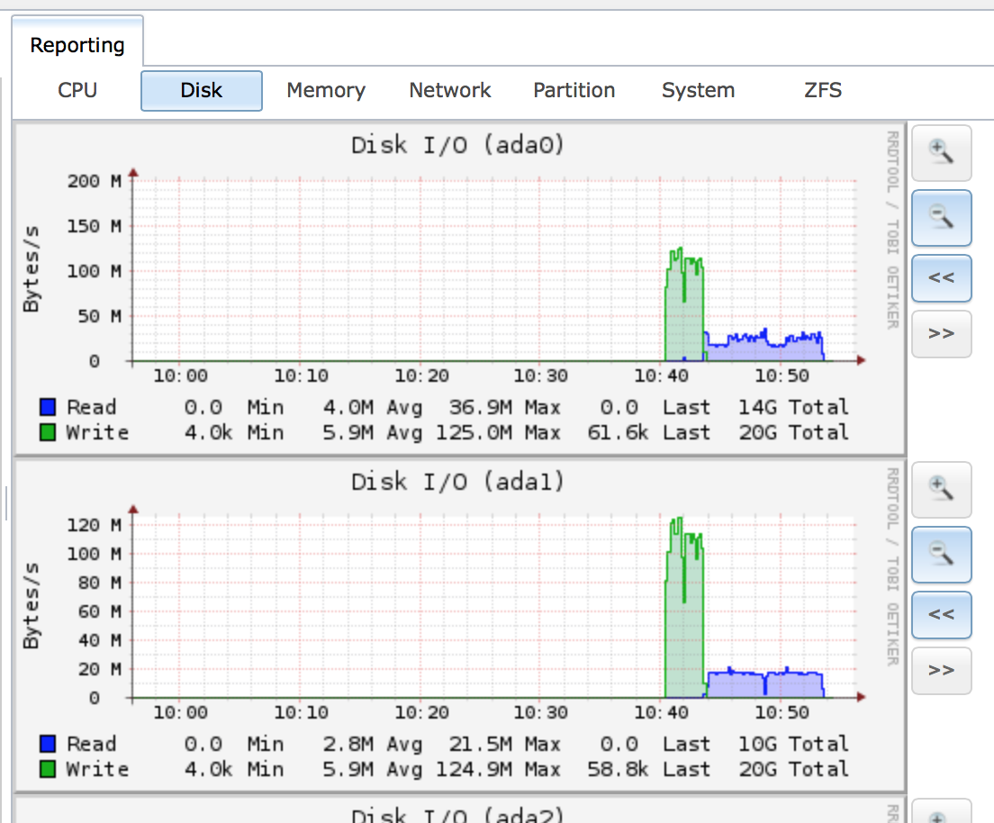

Does seem like a bit of a concern, then. I'm not expecting ARC to save me - my use cases will typically not benefit so much from ARC, so it's good that the test parameters are not attempting to fit within the ARC.
One thing I don't understand is why the raw per disk read rates are so much lower than write during the iostat test (sorry the image is small, haven't quite figured out how to drive the forum).
This contrasts with when I was doing badblocks testing (prior to building the RAIDZ2 zpool) - in this testing, read and write performance was absolutely symmetrical.
I'm really not too sure where to start with this. There seems to be absolutely no indication of hardware issues. It would be great if anyone can make any suggestions about where I should look.
