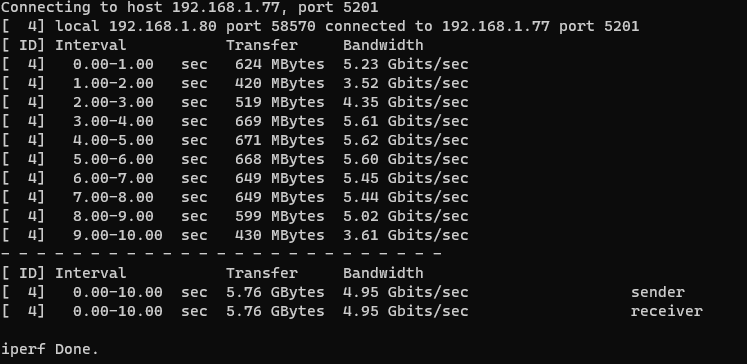

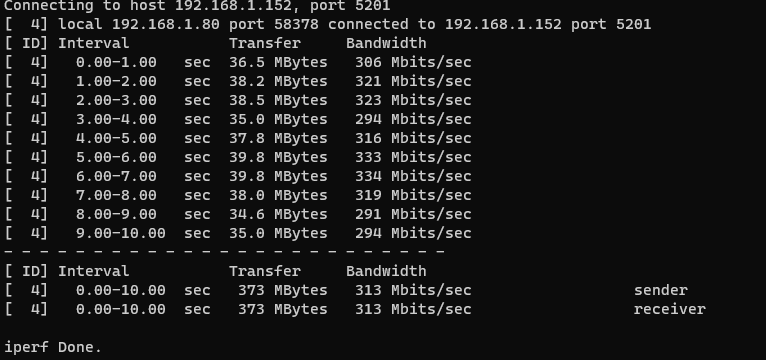

I am currently testing truenas on vm with windows host for a friend, but the bandwidth is too low, around 280-300Mbps, falling below 150Mbps most of the time. For comparison, we're running pihole as another vm with identical settings and getting around 5-5.5gbit/s, which is expected.
Note, all tests were made using the host computer, so cabling or switches shouldn't be an issue but we're using 3ft cat6a cables connected to a 2.5g switch.
Truenas network interface is reporting 1000baseT even though I can pull full 2.5gbit from host, but even then, we're not pulling anywhere near 900-1000Mbps.

Pihole:
Truenas on a good day:

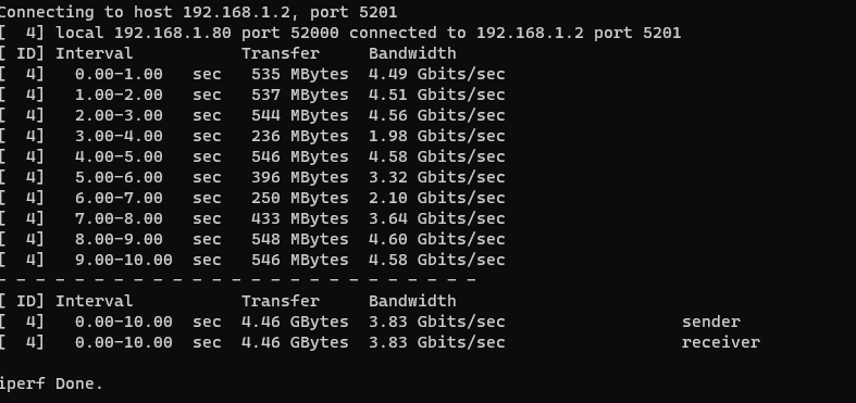

Update: I just installed Truenas Scale with exact same hardware allocation and VirtualBox settings, and the bandwidth is like this:
Definitely better than the current truenas instance. It seems like a problem with Core's network setup. Also, just realized I never told the first one was Truenas Core.
