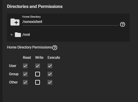

or. wait. hang on. why have you set these directories as the users home directories? that's part of what's missing, what are the permissions on the actual media/qbit media/sickchill folders/datasets?
these screenshots only indicate what group the users are part of, nothing about what permissions are on the folders themselves. the home directories generally should remain as /nonexistant (or whatever the default is)

Oh, so the Directories and Permissions when I create the user should just stay as default?
Like this? Should I remove the users and remake them with the default settings?

well, it depends on your exact goal, but from what I can tell, yes. it looks like you just want to have these users able to write to datasets under media, so since you have the users aligned on the host and jails, it should just be a matter of going to the datasets under storage, and giving the users the desired permissions.
the easiest would just be to give all these users/groups full access to media and everything under it, at least long enough to get everything working, and then restrict access, if you so wish, down to the media/bittorrent etc level.
the OS generally expects only that user will ever use the home director, setting these locations as user home directories could very well cause unexpected behavior, particularly with jails involved.

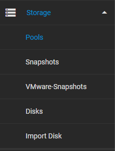

I am unable to find "datasets" under storage.
Is it in pools? If so, I can't see my media folder from there, only the iocage folder. I have seen several other suggestions say the same thing, but I am unable to find where to do this at.

I just figured out how to make a new dataset, so doing that and moving files and seeing if it works.

Thank you for pointing me to the datasets! It's working now. I was just missing 1 step of creating the dataset I needed to change permissions on, which really was probably more me overthinking than anything else.
